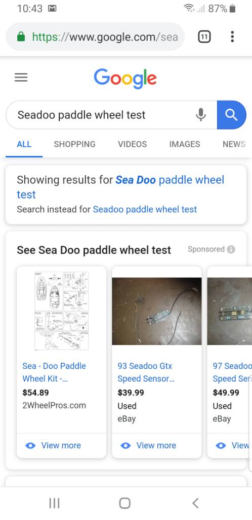

Thanks man !! I've been searching.... but I can't seem to get the right words in there for a good hit. LOL
Great thread to get me started. I've tried to remove the whole block from the ride plate and can never get all of the screws out. The threaded inserts always end up spinning. I think I left these on the last two skis I scrapped. They are that much of a pain to remove. Should I be replacing the whole piece or just the sensor?
I don't have speedometers on my skis, I could care less about it, they're never right. Just a waste of time and money.
Keep your Google search straight and to the point. You can even throw seadooforum at the end.
