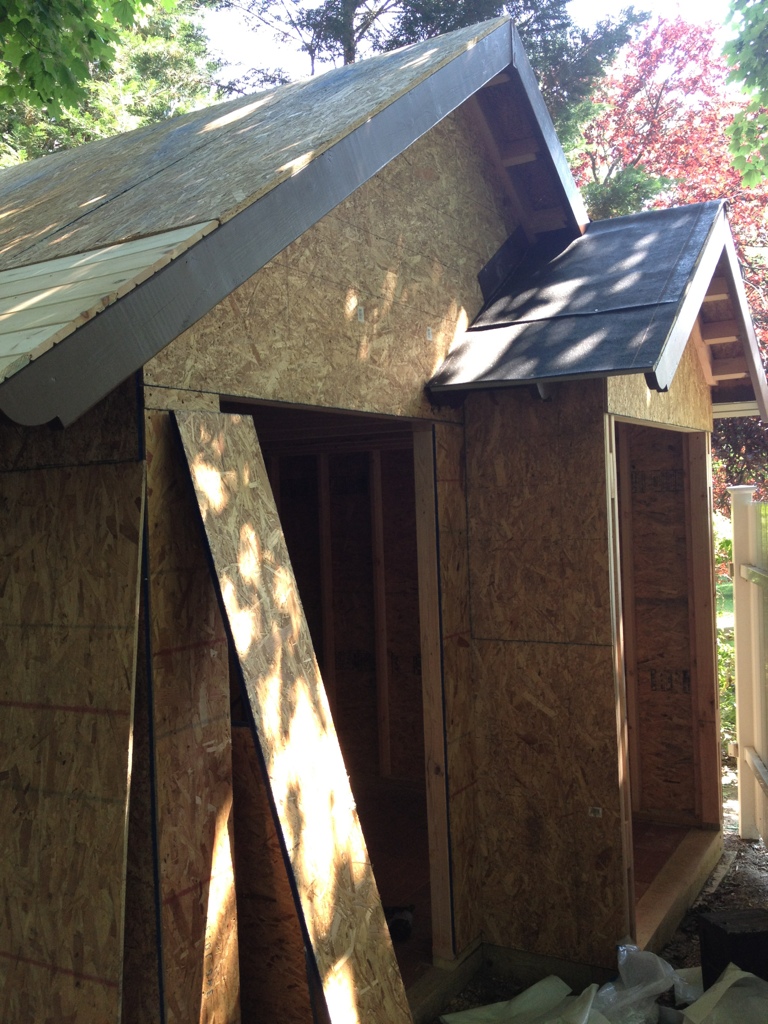

Here is a picture of the shed. The right "bump" out was built to house the length of the jetski.
