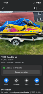

The seller says the body is in good condition except for a few scratches and marks on the front from a previous owner not being careful loading on a trailer. Otherwise it’s solid. In my area I’ve only seen XPs for sale for $2,000+ and those are ones that aren’t running perfectly or cosmetically mint.

Looks clean in the picture but the hood should be yellow not black.
IF you can't hear it run and test the compression as a perfect 150 psi then assume it needs a complete rebuild with crank, balancer shaft, rotary shaft and bored with new pistons and fuel system including carb rebuild. $500 is what a non-running seadoo is worth.

I don’t like that the hood is painted black, obviously you will have to look the machine over to see if it has been taken care of or if it’s been worked on by a hack. Take a flashlight that has a good beam so you can look at the prop and wear ring. Are you in Canada or USA? In Canada a good running one would be roughly 1500.00 to 2000.00, most parts of USA I’m seeing running ones 1200.00 to 1500.00. 1000.00 is maybe a touch high for a machine that can’t be ridden without some work. If it has good compression and spark it should only be the fuel system that will need repair and you can do the entire fuel system for about 220.00 USD. Of course could be other stuff like brass gear on the crank. The really good deals are usually gone with in an hour on marketplace so the fact he still had it, tells you it’s not a smoking deal but it may not be a bad deal either, sorry, just depends a lot on how looking it over goes. Take a good compression tester, good battery, flashlight, spark tester. Heck, if he will let you, take a little mixed fuel and put it in the plug holes. Personally I don’t like to do that, in case it starts and runs well on the fuel in the plug hole, makes negotiating difficult
