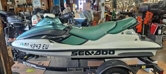

Recently bought a used 01 gtx RFI for the kids to play around on when we take the big boat out. Anyway, I bought it from a guy as a non running ski(ie cheep).He stated it just quit and now wouldn’t crank, no beep with kill lanyard, no dash.I brought it home and checked it over. It ended up being 2 blown fuses and the dash shows 147hrs. I cleaned the fuel and oil tanks, checked the compression and found #1 cly full of oil. After cleaning it out the compression was (145 mag end, 150 pto side) so I decided to take it to the water and let it run easy on the trailer before running it hard. I let it run for about 10min easy and it sounded perfect, idled well so I gave it one or two quick burst to about 5k. On the last one it acted like it bogged for a split second and then quit…like locked up,quit. I called it a night and decided to look at it the next morning. Plugs show no sign of water, I was able to get it to roll it over so I could scope both cyls and they look good and now it cranks again, but it was definitely locked up. I didn’t recheck comp as when I cranked it #1 blew oil again so I am assuming the rotary valve cranks seals let go. I verified by draining the oil and pressurizing the rev chamber and in less than 30 seconds will go from 5 to 0. So it looks like a lower end rebuild is in order and I will probably do the top end as well just to do it. I can see on the tops of the pistons they are .25mm so it’s been done once, but the paint isn’t cracked on any of the bottom end so it’s probably original. Anyway, is this something people attach themselves, or do most send them off? I’m not scared of it, just questioning myself as it is a little different than what I’m use to and I’m sure I will have to buy a few more tools, which I’m not against. I just want as reliable of motor as is possible.
For context, I have been in the marine industry for 30+ years, a Mercury certified tech and evinrude master, but we have stayed away from pwc’s as we have never been able to keep up with the work on regular boats. So I’m very familiar with 2-s engine and have rebuilt 100’s of them.
Thanks!
