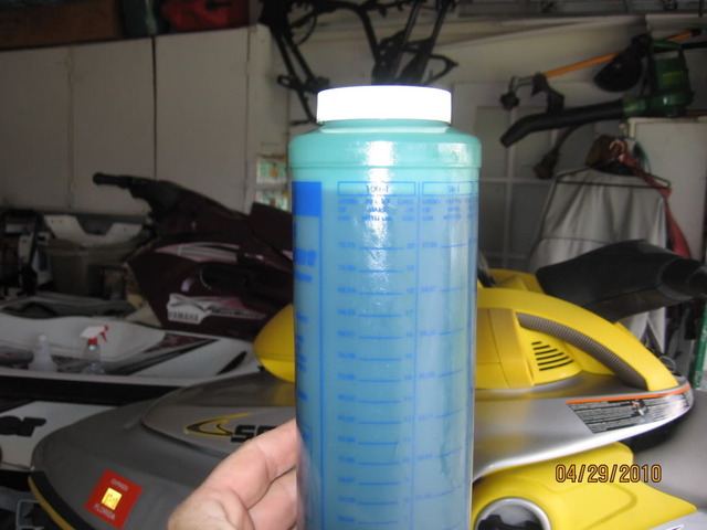

He did (shop owner) mention lower crank bearing. I don't know engine talk but I did write down what he said. And, then he said he would take care of all cost adding the Oil Block that would require pre mixing my gasoline from this point out. Thank you for mentioning the ratio rite cup. I am a quick learn on just about anything. This is a new subject for me. And, with all the trouble I've had I feel like I am taking a very accellerated course.

1) I'm fine with premixing, its EASY, i've done it for 5 years on every ski I own.
2) ratio rite cup sux !!!! no lid !!!
3) because the RRcup sux, go to a West marine, and get their premix container. No cup ! $5.
take's all the guesswork out, seals with a lid, no stinky oil smell in your trunk, no sticky residue from the cup...
I used the ratio rite cup once, and threw it away immediately...
