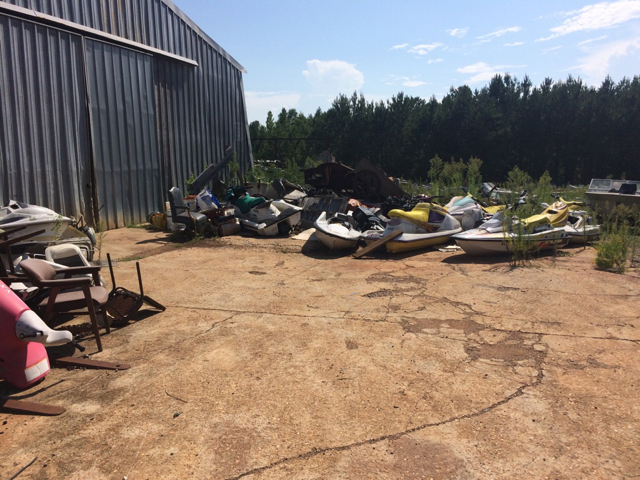

I rescued a 95HX from there some years ago, we drug it out with a fourwheeler, red mud and all, he has bought many skis from me over the years and I have bought many parts from him. It's kind of funny I nicknamed it the junkyard dog lol
Small world. I peeked through the fence not too long ago and he's getting some 4tec skis in now. I'm hoping he can get a spark in so I can swap the motor in an X4 hull.

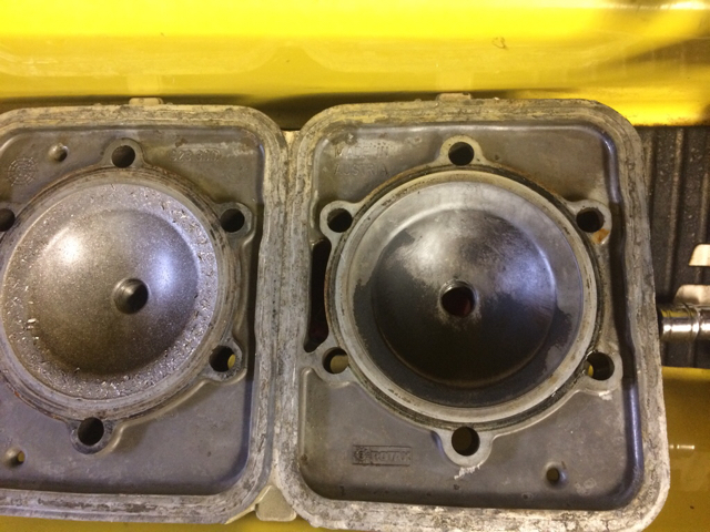

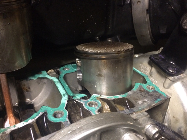

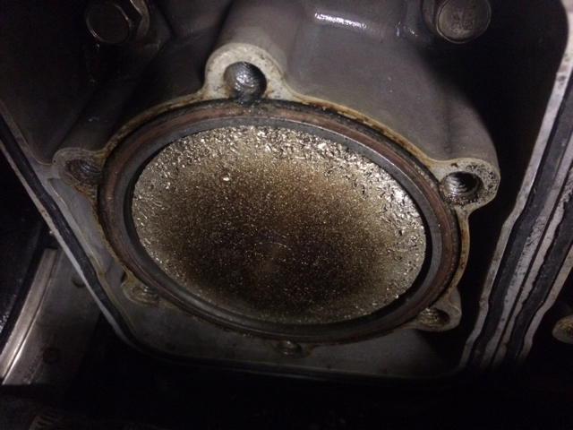

My personal XP decided to eat a MAG cylinder at some point last season. I'm not sure what caused this. Luckily the walls aren't scored, so I may be able to get away with a new piston and hone. (Story of my motor life recently). The other blessing in disguise was finding the crank shaft is worn slap out- worse than my parts motors! If you remember, this was an untested junkyard motor, so I did get some time out of it. So now I'm trying to decide what to do. I have 1 parts motor that may have a good crank, but that its still TBD.
My pride is kicking and screaming when I say this, but I'm entertaining an SBT motor right now. As much as I want to build some bulletproof race motor, time and mostly money are against me there, so that makes the SBT route the most cost effective option at this point.
Man I ran the chit out an sbt engine in my 96 xp. No worries just beating the dog piss out of it when you have a no fault warranty. Their shipping is rape though. Mine ran dead on oem specs, I can't speak for all of them though
I'd be going back through the fuel system, looks lean to me
I will be so this won't happen again.

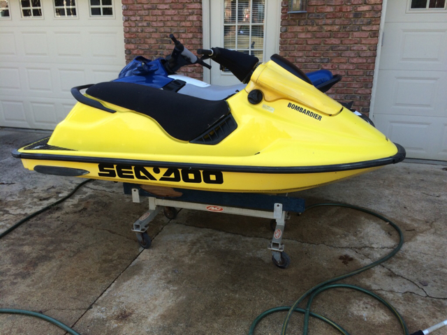

#2 out of hiding:

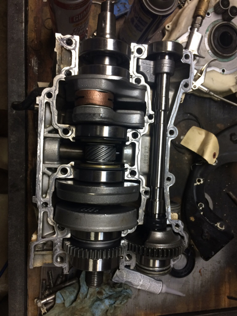

I ordered an SBT crank and counterbalance shaft that should be here Friday (the rotary shaft checked out fine). The goal is to have the bottom end built and ready for a top end by first of next week.
Progress has been a little slow mainly due to paying fab/ mechanic jobs coming my way, but a little extra cash never hurt anyone.
I got the inside of the cases cleaned up and the bottom end assembled:

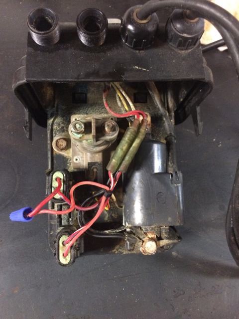

I also pulled the rear ebox from my parts XP and began to clean this mess up and put together 1 good box out of the 4 I have laying around:

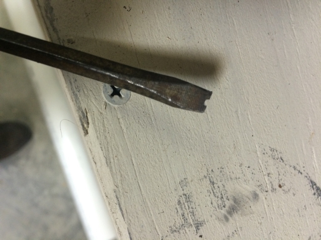

I dug the ski out of storage today and got the motor 75% assembled, which I won't bore you with pictures of a 787 build. What I will show pics of was the tool I made to help with getting the stupid circlips in with:
It's an old screwdriver with a notch cut in it that made installing the clips some easer. It paid for itself I guess...

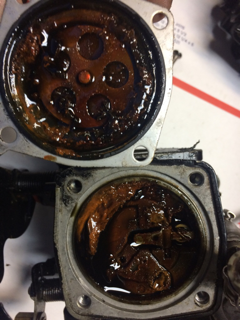

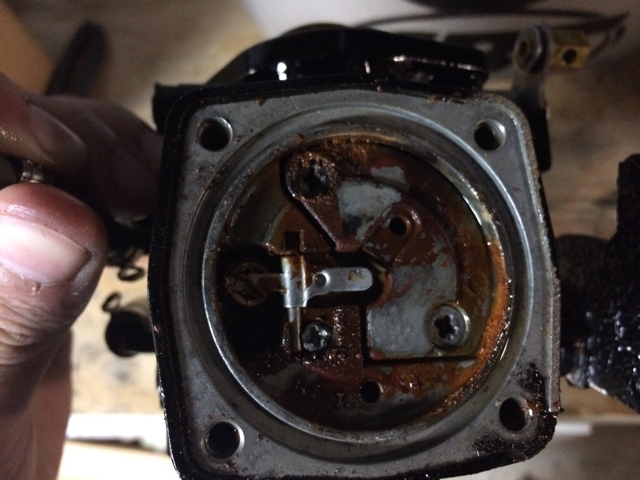

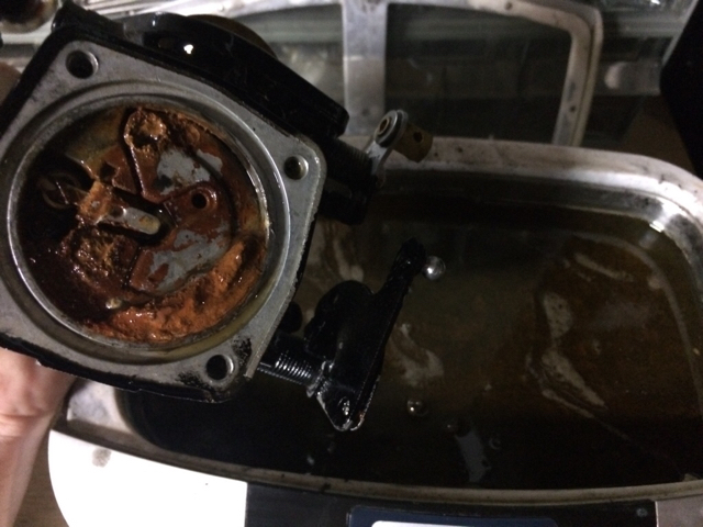

I started working on carbs today. When I pulled a carb off the shelf to rebuild I found this-
Harbor Freight parts washer to the rescue!
Please post an after picture because I don't beleive it's gonna clean those carbs. If it does I'm gonna buy one of the harbor freight parts washers !!!!!!
What I have is the Ultrasonic Cleaner, which is intended for jewelry. Using either Super Clean or Simple Green, I have had really good results with it. It works amazing when cleaning dirty hardware. It's not a miracle worker, but it saves time and eye fulls of carb cleaner for sure. I've had this unit for a year and am pleased with it. There's lots of info online as well.
After a few cycles with 100% Simple Green:
A quick spray with carb cleaner:
It did a good job loosening up the sludge that was there and made it easy to get clean. What's left is going to take a wire brush to get off.

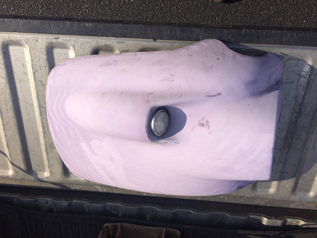

Yeah, they have a lot of parts. I snagged a single gauge hood for my other XP to attempt to add a GSX info center and tach to it.
It's faded, but solid. Should be the perfect candidate.
