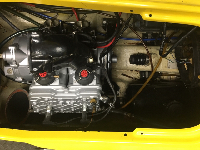

Slowly but surely chipping away at this thing. The motor is aligned and locked down, carbs installed, exhaust manifold is in and now it's down to all the little details that take forever.
Even though this is a flipper ski, I'm too OCD to let some things go. Bolt heads got painted black:

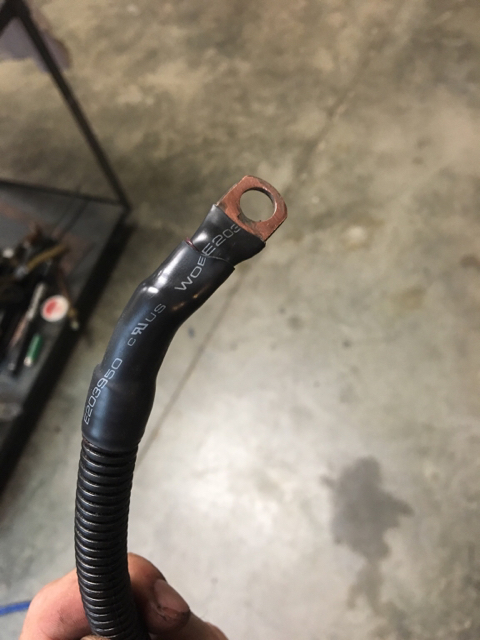

Ground wire on the starter was cleaned up:

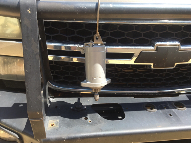

The starter itself was inspected, cleaned and painted:

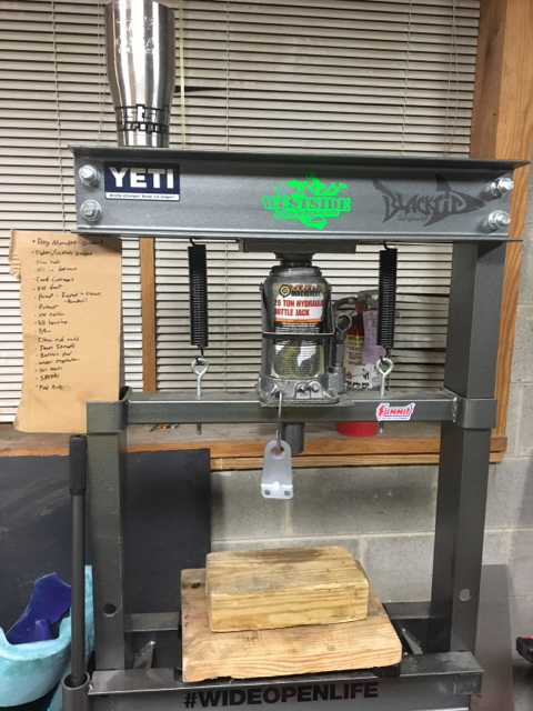

How do you like that HF press.
I don't know how I went so long without it. One of the best cheap tools I have gotten from them.
Nice work.
I absolutely love it. It's been used far more than I ever thought it would. I've got some minor mods I want to do to it in the future, but it's been great as is. I do a fair amount of metal fab work when I'm not working on Seadoos, so I'm looking into a Swag Offroad press brake kit so I can get more use out of it.

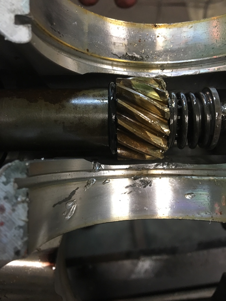

Also, here is the brass gear:
It looks alright and spins fine. Where should I go from here?

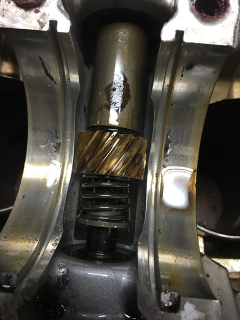

Ever have one of those ideas that sounds like a good idea at the time?
Is there a prayer of these cases ever working again or is it a lost cause?
After breaking every tool I had trying to get the rotary shaft out, I tried the air hammer and it slipped. It was a dumb idea, I'll admit
Make sure you remove the snap ring that retains it.
Then I use a cheap harbor freight slide hammer threaded into the gear side and within a couple pulls they come out.
Yeah, I definitely forgot the snap ring. And yep. I feel like an idiot.
Got the RV shaft out with no trouble. I'm going to clean up the damage and gamble these cases will pass a pressure test. Fingers crossed.
