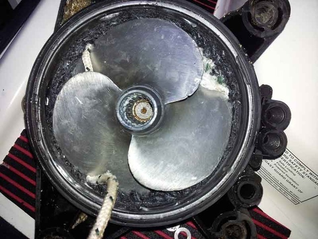

Last week I got a rope inside the pump on my GS. The engine stopped and I had to return to the beach swimming.
This is the aspect of the pump. The rope melted into the wear ring and was very difficult to get out.
I already changed the wear ring but during the initial test on water the ski had a slight vibration that was not there before. I got the drive shaft out and went to get it measured. It had a deviation of 1mm, so they fixed it.
Question: Judging from the photos, would you say that the impeller is bad? Would you suggest me to switch to a new one? If it’s a yes, which brand/model would be appropriate? (Sea Doo GS year 2000).

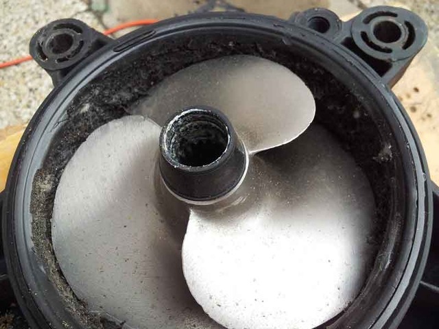

The impeller looks good from those pics. If it has any small nicks, you can file those down with a small file.
Post some more pics if you have any bad spots.
I've seen many ropes around the shaft but never as bad as yours. Hope everything worked out OK for you.

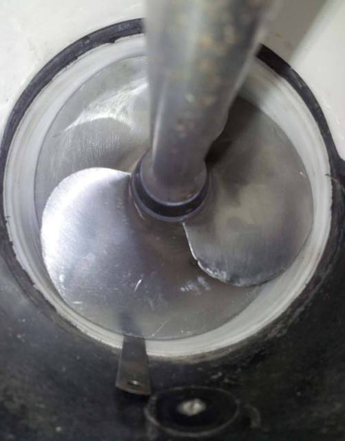

Everything works ok, but I'm not totally sold on the new white wear ring. No lips like the OEM and it was very easy to put (like it is a little bit small. I used a couple of screws, just in case it wants to spin.

Post a picture of the newly installed wear ring with the impeller. Let us see the gap.
Anything wider than a width of a dime is too much.
White WR installed.
Measuring the gap. Aprox. 0.13 mm.

What size is the feeler gauge you have in there?

It can also be diameter of the prop...they get sanded down over time from sediment..but Im an OEM only wear ring guy.
Also...when things are apart after a rope incident you should always roll your prop on a flat surface and see if its bent. just like a pool cue.
Good point on that it could also be the prop. Bottom line, impeller or wear ring, 10-thousands of an inch or more becomes an issue.
If you do buy a new impeller, measure it at it's width and then measure your old one. This will tell you what was wrong and you may have a backup impeller.
your wear ring, clearance, and impeller look fine. a bent drive shaft will cause a vibration and cavitation. it can be straightened and will be fine. if it was 1mm out you said, that was your vibration problem.
