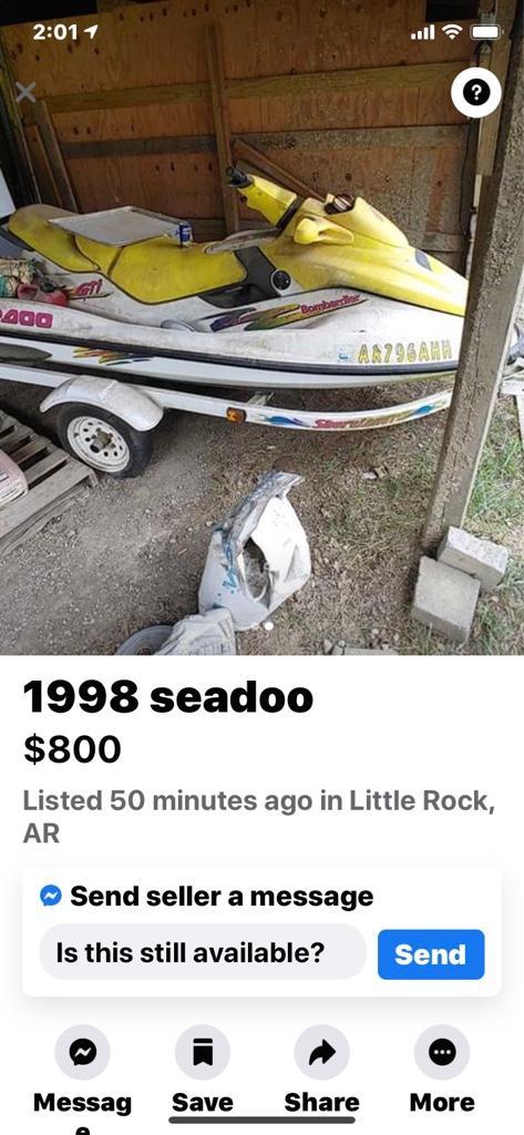

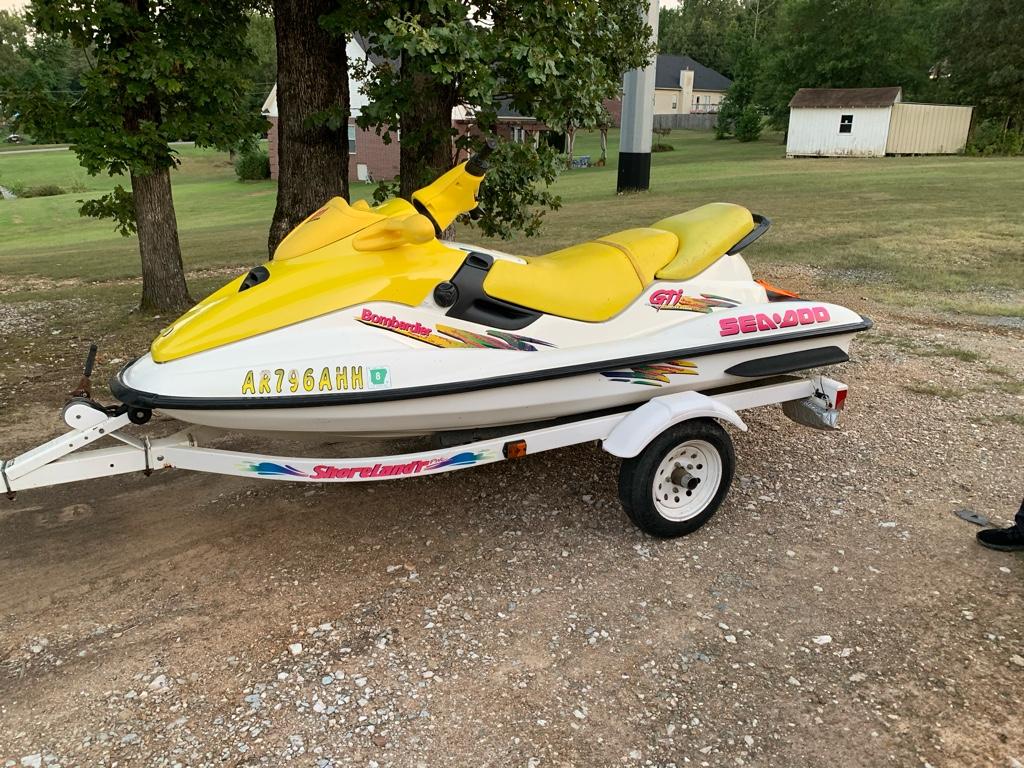

1997 Seadoo GTI with trailer for $840. Surprised to get it because everything is selling here within a hour of posting for ridiculous prices. Haven’t had a chance to look into it yet. Jumped the solenoid to see engine turn over. The fuses were broken in the front EBOX to where plastic insulator just pulls off. Plus we ran three large rats out of the ski and it reeks of urine. Only found two wires chewed in half and they were to the gauges. Hopefully this will be a quick fix. Nice thing is it’s all there. I’ll check the fuel lines today to see if the gray tempo lines were still present. New fuel selector, new oring for fuel filter basket, rebuild carbs once OEM kits available, service the pump and inspect the wear ring.
