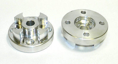

Just found this. Wsm makes replacement pto's for this. The 98 xpl pto is a hard part to find and always goes for over $100 used. These are on ebay for $65 shipped, could have used one of these a month ago.
Yes they just came out with those billet ones. They have them for the 97XP also. I need the rare 96 HX pto so I'm watching to see if they come out with that as well.

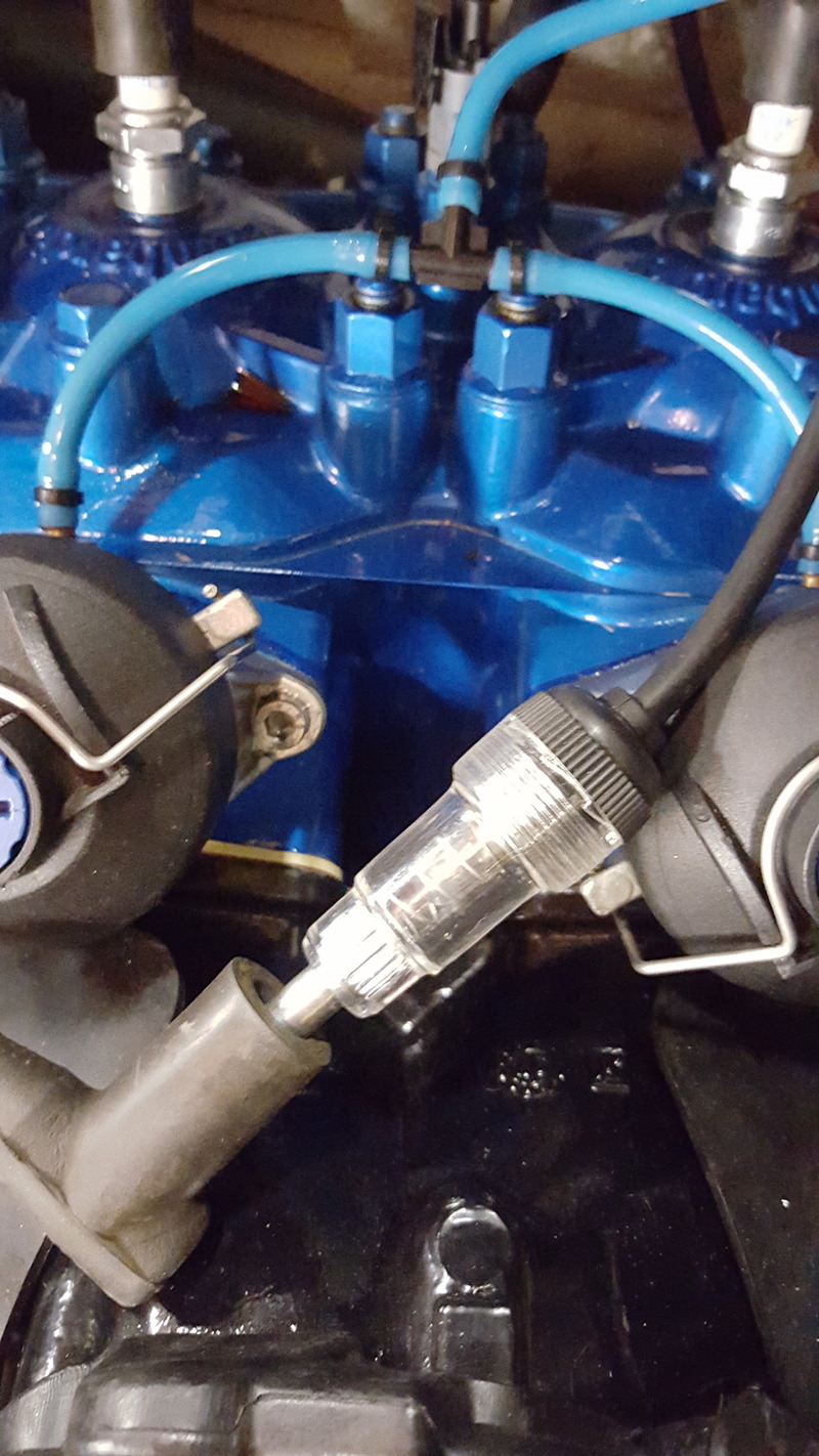

Get it on the trailer, pull the plugs and beautiful red oil comes pouring out. Immediately check the oil pump, the hoses are all attached, no slices. Check nipples on the intakes, they are fine too. Check oil pump again, no bleeder screw. It backed out and leaked out a good quart of oil. Now I am worried the motor may have siezed. Pull the plugs and they both look good. Rotate motor and she turns fine. Luckily the oil lines were all still full and my gas has a bunch of mixed oil too.

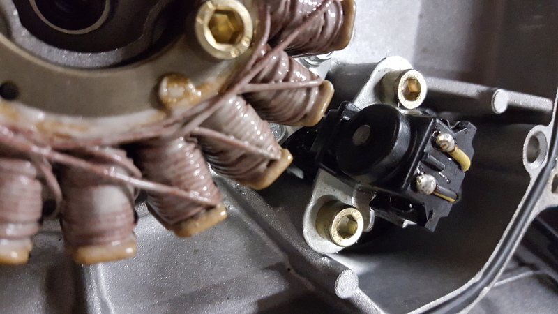

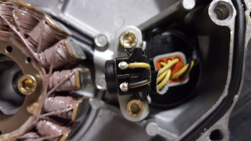

Changed out stator, still no spark.
This is the one that was in there.
The pickup looks great
