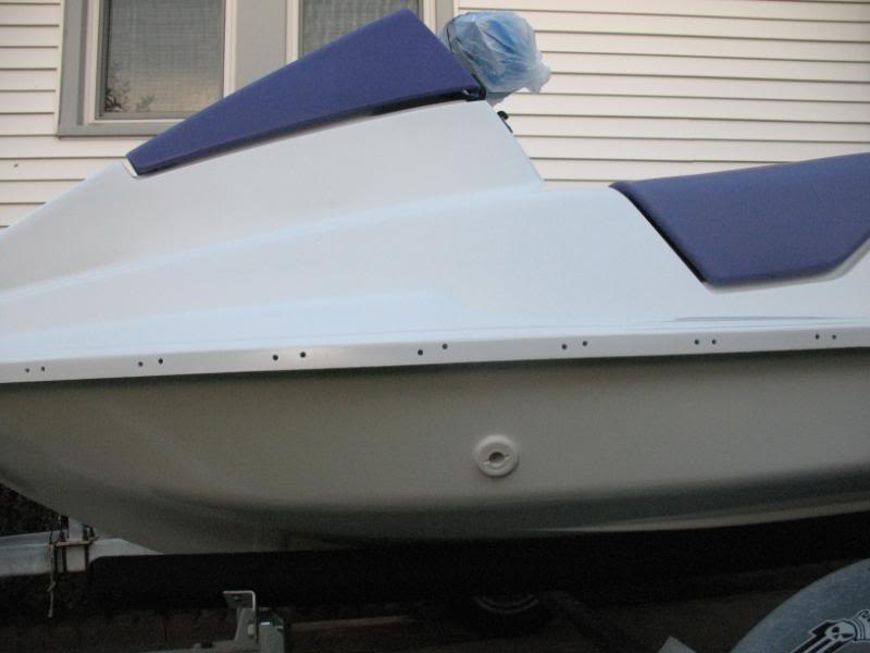

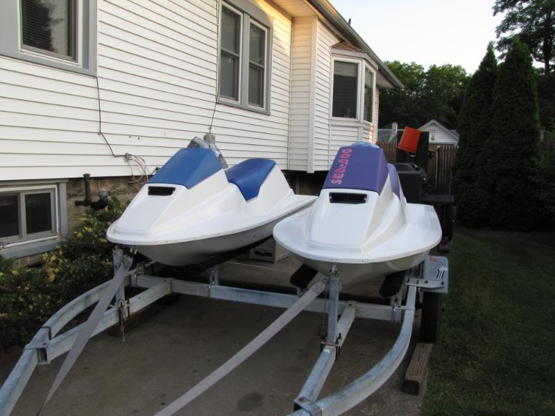

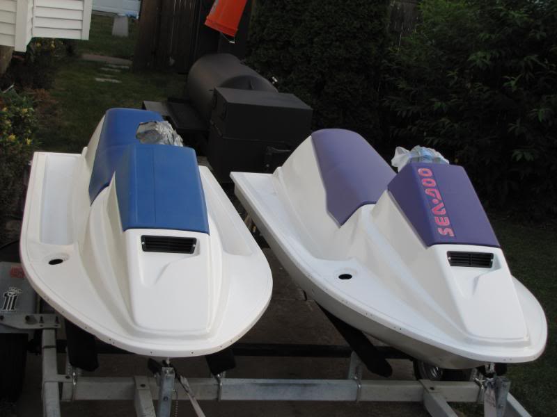

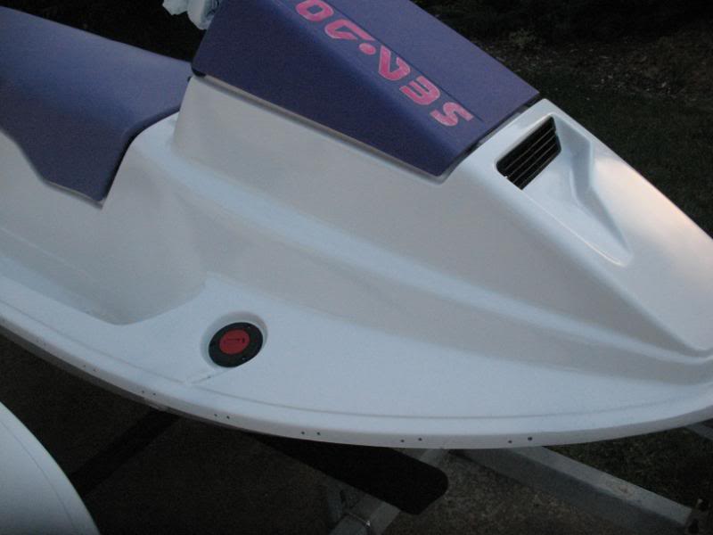

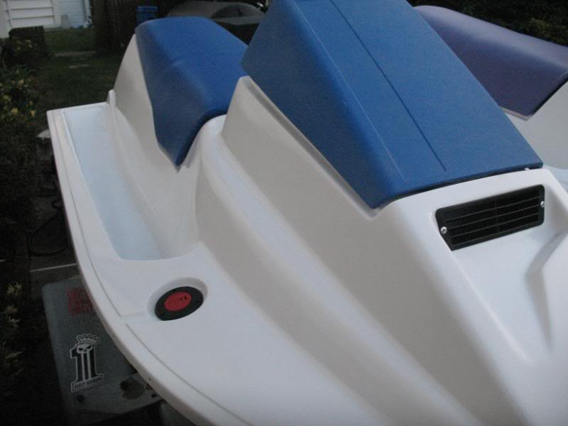

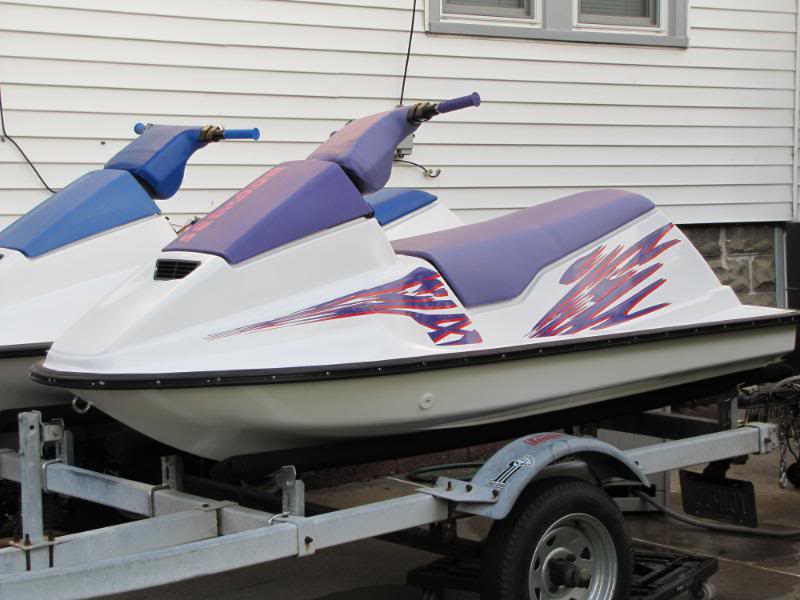

I Finally have both Hulls back from paint. I assembled a few parts just to keep the rain out. Here are some pics:

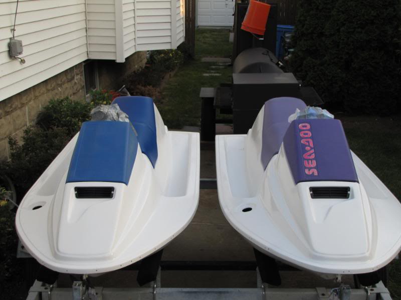

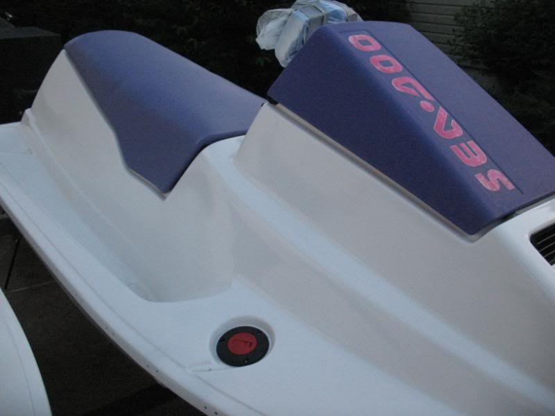

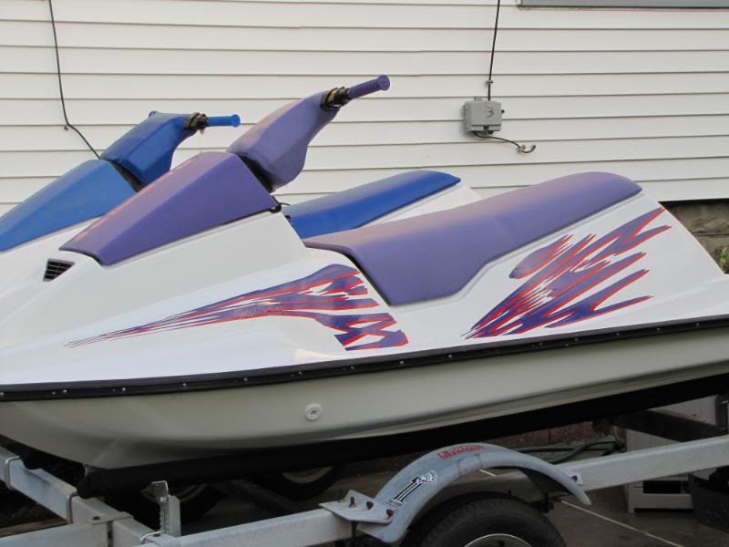

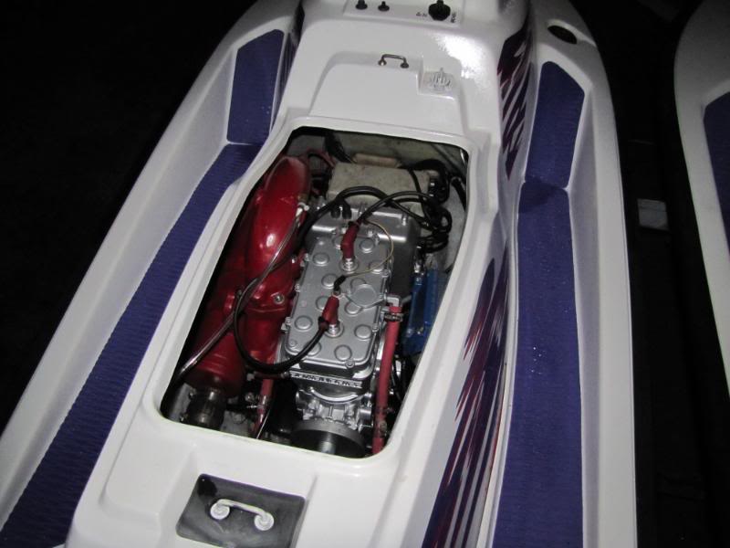

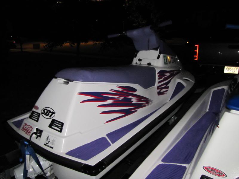

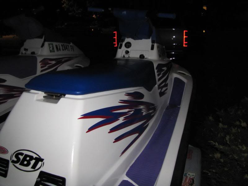

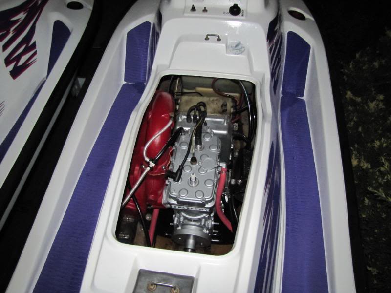

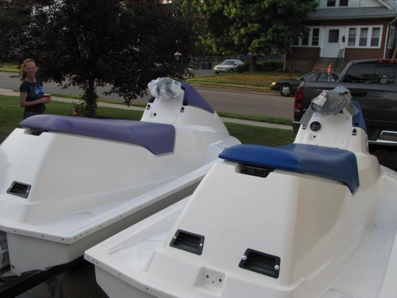

final update ...I think I am finally done

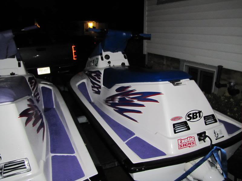

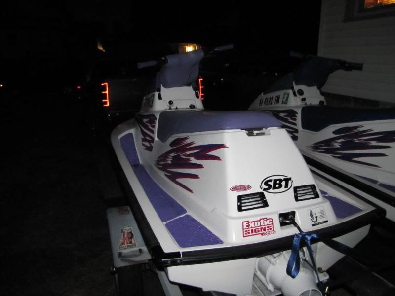

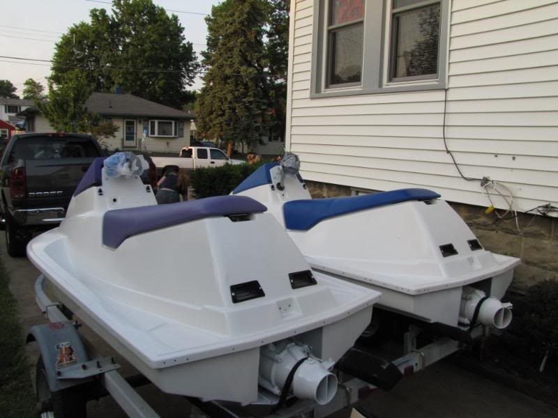

Dunked both of them in the water today. Left them on the trailer and removed seats. Fired them up and had no leaks and the pissers were pissing. I tweaked the carbs and got them idiling smooth. I will be riding them tomorrow to break in the new engines.Here are the final pictures.
didn't get done till late so had to take pics in the dark...Thanks Seadoo snipe and Dr. Honda and every one else for all the help...couldn't have done it with out this forum.. Shaft seals didn't leak so we shall see about the wear rings tomorrow.
looks good. Post up some pics of the test ride.
Did you find a new rev-limiter?
Yes I did.....then found out I had been beating my head against the wall for the better part of 3 weeks because I had a bad kill switch button !!!!!!! It was weird, I would have spark then not have it and would change out a part and then lose it again. I am not taking that handlebar pad off again so I just eliminated the kill switch and will just use the lanyard for now...Maybe in the offseason I will change out the button.....gives me some time to find one.:willy_nilly::banghead:

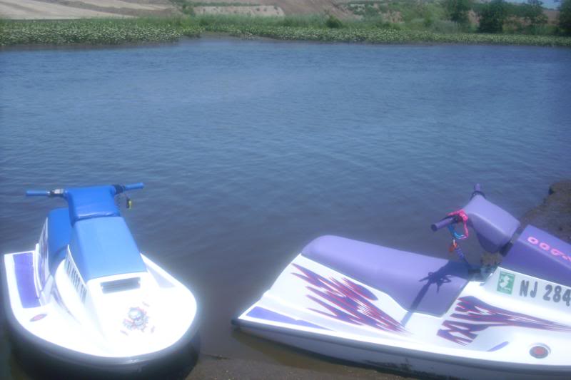

Well? have they done a proper sea trial yet?.. How'd they run on the water?
They ran well. I was pretty pleased pumps are fine and shaft seals were good. So no leaks and they float and start. We rode them all day saturday. I tried to take them out Sunday an one was acting up...some kind of fuel delivery problem....but I will get it figured out...With the help of this forum.
