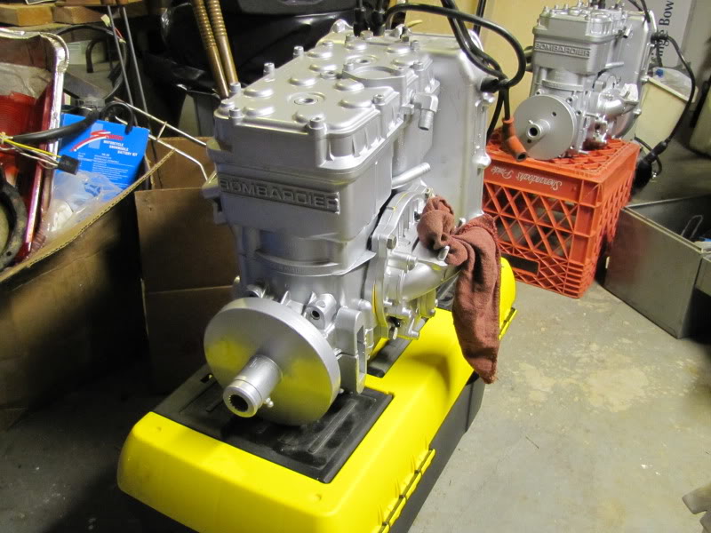

just got the engines back....

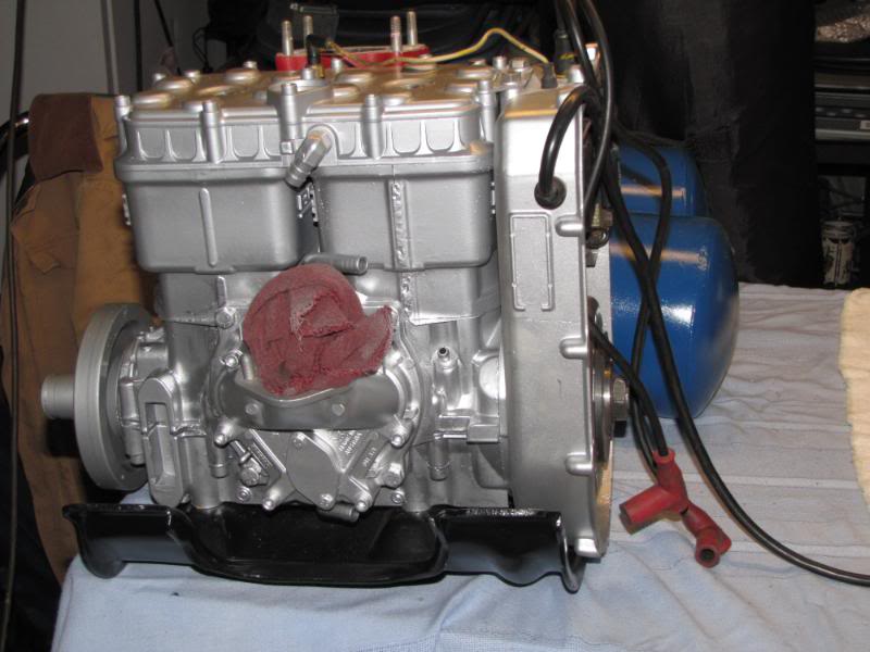

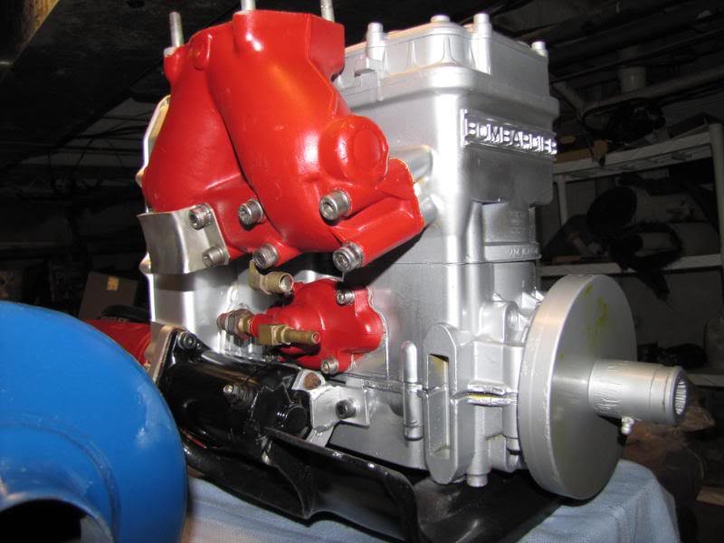

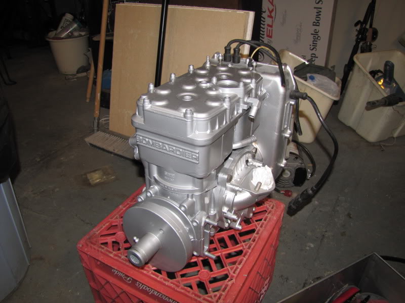

I havaen't posted in a while... Finally got my engines back.had them painted silver because I couldn't stand the ugly yellow they used to be.
The dude at the shop.forgot to put the lower oil tube on one of them. So now I have to take the rotary cover off so I can thread that tube on. Even though I am premixing I still need to lubricate the gear.

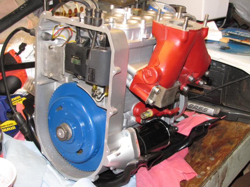

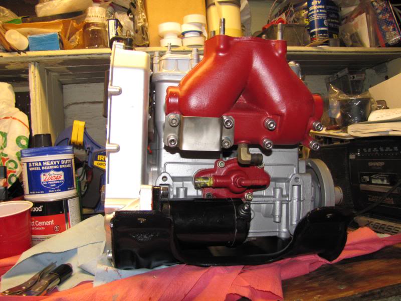

ok, got the engine mounting plates bolted on along with the , starter, water jacket and exhaust manifold. we are moving along.

Looks Great !!! The guy that painted my one hull forgot to add the hardener :redface::rant: It never dried. I had started putting some parts on it so I had to take them all back off. Then it never really dried. So we couldn't sand it and we had to tak a Lacquer thinner and scrub the whole hull down to get the paint off. Now it is painted again. I am waiting for the other one so I can drop in the engines and get to work. If I don't have them done by the end of May they won't get done till July as I am booked up every weekend in June. I really want to get all these parts and stuff off my basement floor and work bench. I have decals and hydroturf and new vinyls for two boats laying around just waitig to go back together. The guy that redid the engines is from a place called EastCoast Cycle Center..I do not recomend them as he took over a year to get my engines done!!!!! He told me a couple of weeks. As I am putting together one of them, I notice he didn't bead blast the one that well and just painted over alot of stuff. He didn't put the lower oil tube on so I had to take the rotary cover back off to screw that on. While I am taking the rotary cover off I see he used bolts from a white engine old bolts !!!!! They advertised that they would rebuild the crank trued and new seals and bearings and everything would be back to OEM specs or better. with a year warranty. Their price was 300.00 more than I could have done the top end for. So I went with them. Big mistake. The day I picked them up, there was no paperwork for the warranty no break in oil no nothing. I am praying that the whole engine was done. I know the top end was I can see that. He tells me a few months ago that the flywheel was Rubbing...I bring him another one. He tells me that one is rubbing also, so He says he can get one for 20.00 I said fine do it as I want to get these things back together it has been a year. He says"ok call me in a week". I call him in a week he tells me the guy sent the wrong flywheel call me back in two weeks. So when I finally pick them up a I see both the flywheels I left him are on my engines. I can tell because I painted one of them so I know it is the flywheel he told me was rubbing. Whatever I just hope after all this work I have done to these things the engines are fine. My thoughts were if I have everything back to new condition then if I maintain them propperly from day one then They would last for a long time. I am having doubts right now as I am not positive that the bottom ends were done correctly. Maybe they were but I have my suspicions.
that engine looks brandnew..is that a 650 or 550 engine?did you have them full rebuilt?
it is a yellow 587 I wanted it silver because I hate that ugly yellow color. I painted all the other parts the colors I wanted.....( whatever free paint I got from work) We had some high temp stuff at my last job. So I painted what I thought would be a decent color scheme for an engine nobody will see. I talked to the dude who rebuilt them and he is swearing everything is new (rebuiltcrank) on up with WSM parts so we shall see. 1 year warranty.

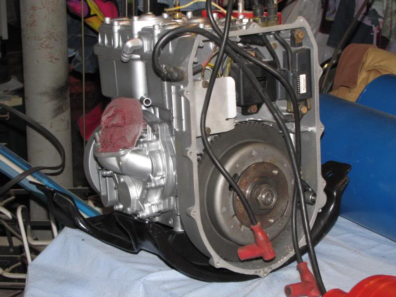

I did not do the pumps yet...I am going to wait and make sure they run. The engines have a full rebuild but I want to make sure I have spark. I didn't want the pumps out just yet as I saved and marked where all the shims go. so once the engine is bolted back in, it should be pretty close to being aligned. My thouht was if I had the pump AND the engine out at the same time the it would need the alignment tool which I don't have. Plus the pumps may be ok. If I get them done and running for this year then I can have the pumps done over the winter. The last time they were registered were 2006 and they just stopped running right. no pum issues. I undrestand from sitting I guess the seals and maybe the wear ring coul have gone bad. I will trailer test the first. I am also installing bilge pumps (just in case) I am more worried about the bearing seals more than anything else. If the pumps cavitate, then I will rebuild the pumps this year obviously. I am taking a wait and see approach on the pumps.
