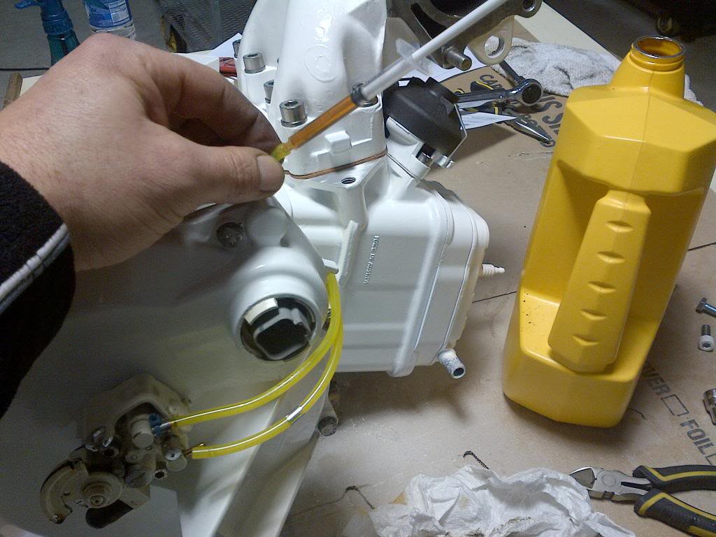

Your area correct on the bleeding of the oil lines, one side goes then the other. It does take a bit of time to get them fully bled, which could be hard on the starter if you are priming without it running. I fill the lines up with oil before I install them. If you do that the line need to be unhooked from the pump,

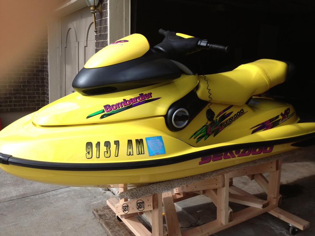

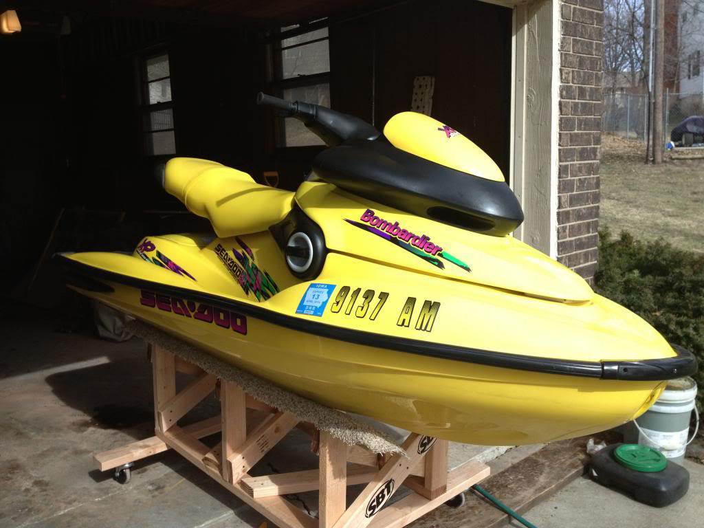

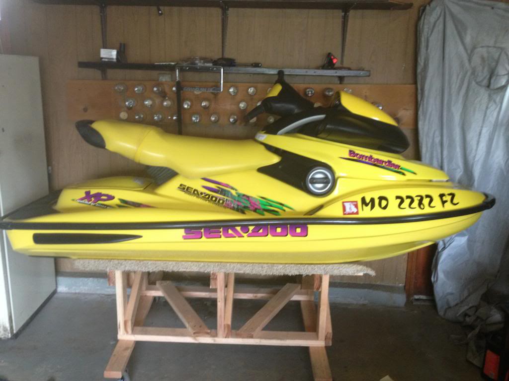

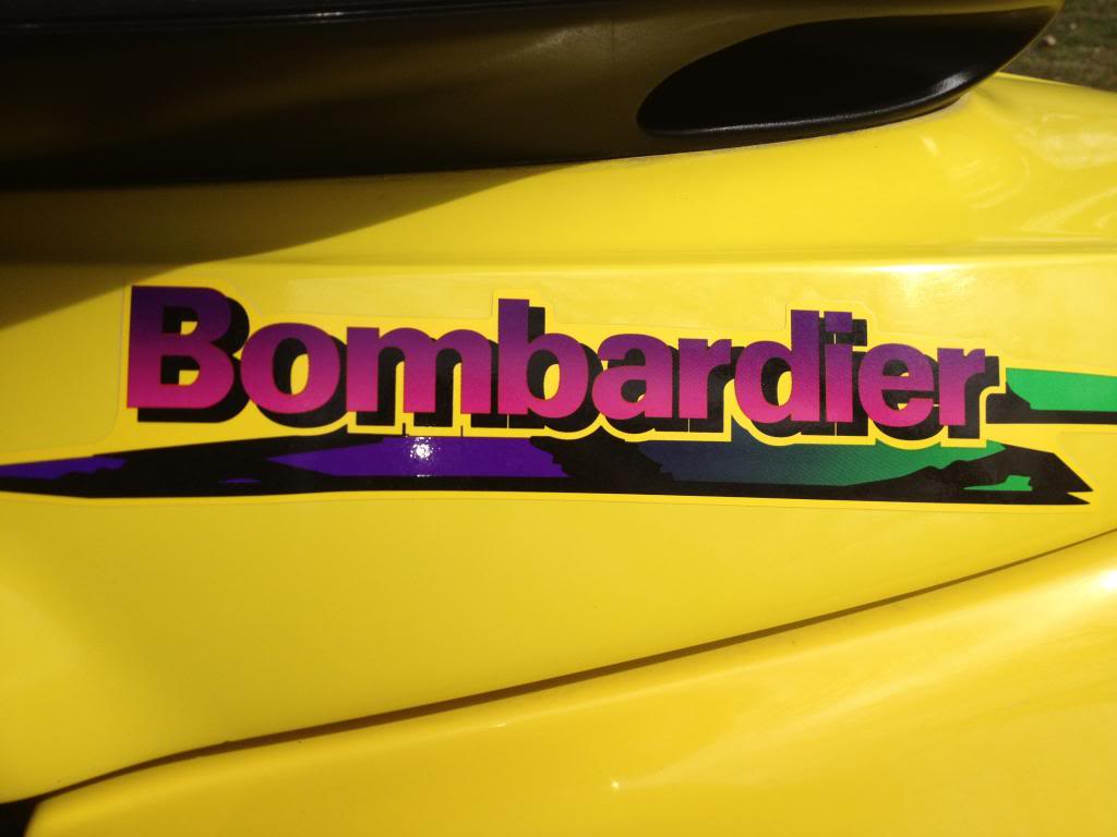

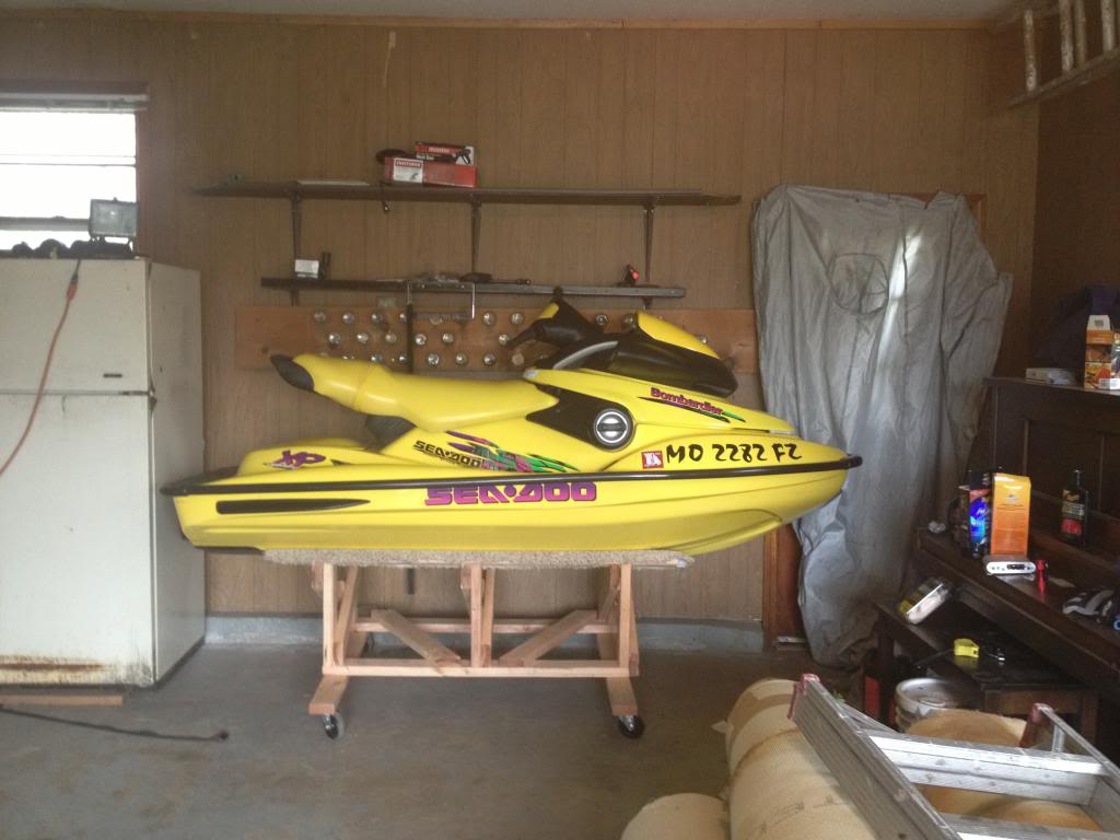

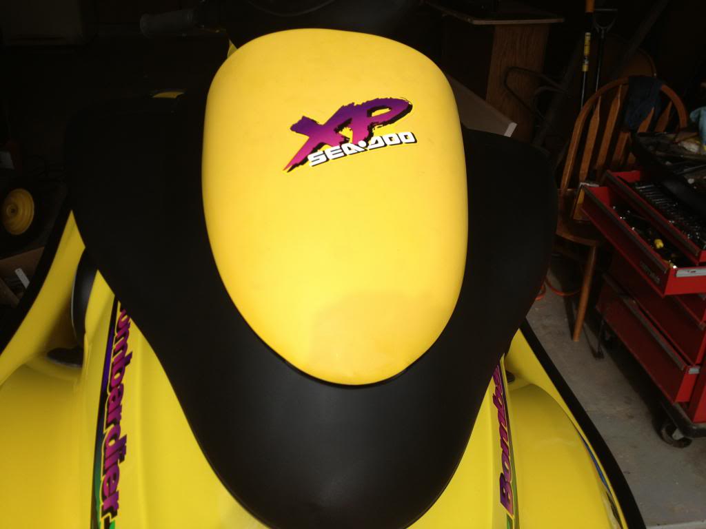

Well i just realized that I never really gave any closure on the thread, but as of today this thing is finally DONE. I got my new decals in from [MENTION=16022]Dr Honda[/MENTION] just yesterday, and I put them on today. They look great. I skipped out on the dual colors with like dark purple, and now Im glad I did. I really like the black and yellow, and this pink and purple is killing me. If I get a few trouble free rides, I think im going to rip off the decals and throw up an all black set on there. I really think it would look killer, but I want to make sure it doesnt shoot craps first.
I also changed out the jet pump oil, damn that stuff was STANKY. The wear ring and impeller on this thing is PERFECT as well, so that is good. All in all she is back under the cover, ready to rip. Here is some pics of it all buffed out and the new reg decals on it
