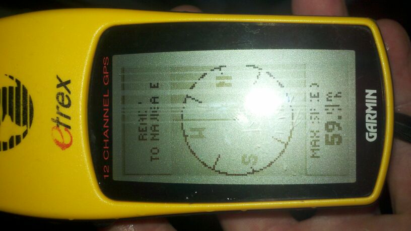

I'd love to help test that theory if you have any ideas. Pretty sad I cant get another 3-4 mph without race gas, considering I am running 87 now at 59+ mph. This is such a 180 compared to my days working with the Yamaha GPR, where you could go from 63 to 80 mph on a ported stock motor with 93 octane.
