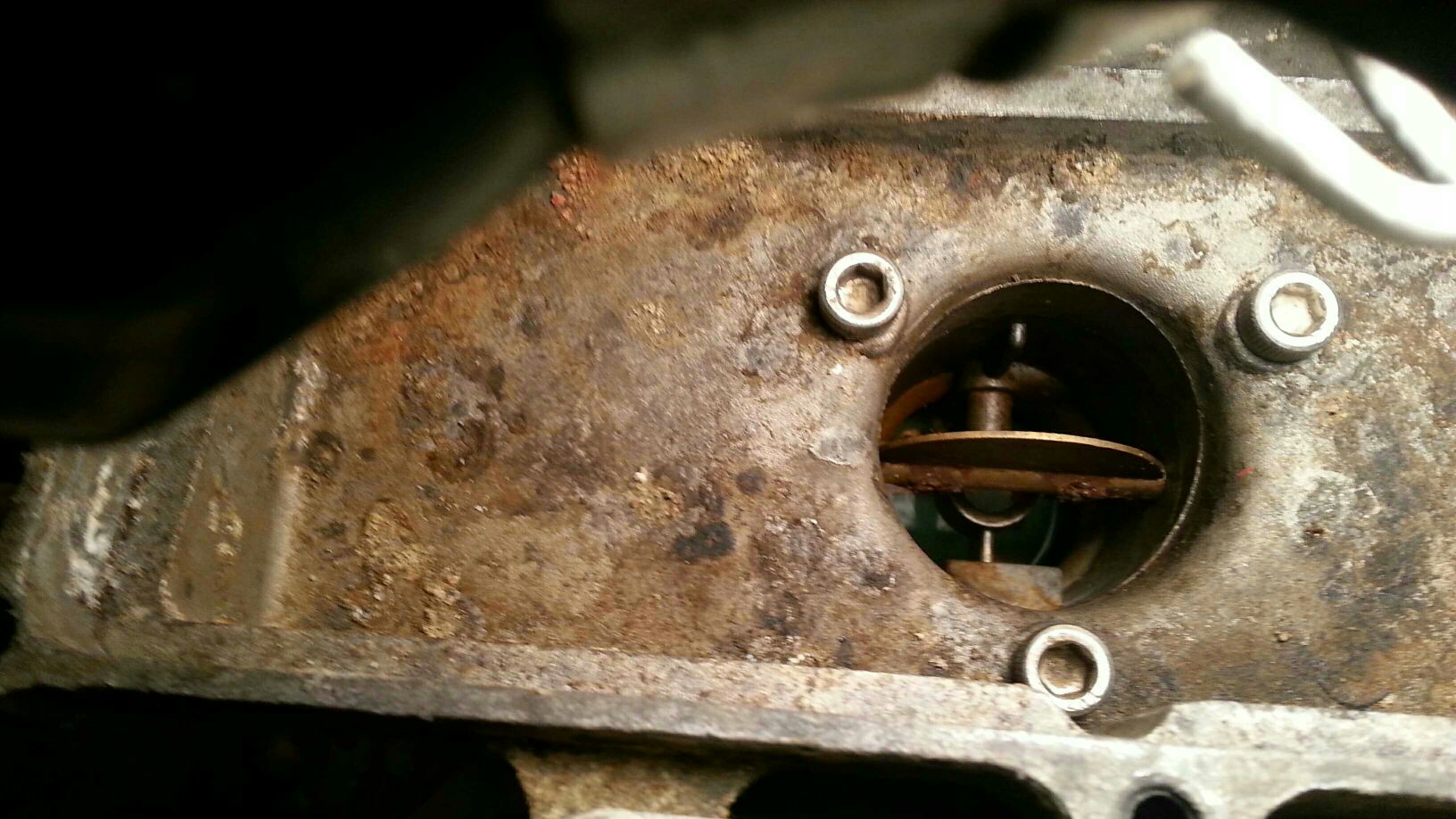

Pulled airbox and air filter, here's a pic, its not pretty:
From the pictures I would suspect water in the crankcase and a rusted crank. To me that looks like rust and corroded water not fuel.
Smelled like fuel but will double check. Any way to easily drain crankcase if it is water? I can pull motor as its mounts are broken at the moment.
If it is water the engine is dead and will need a full rebuild.
Seems to be gas with oil on a second look so fingers crossed. About a tablespoon of it, cleaned it out now.

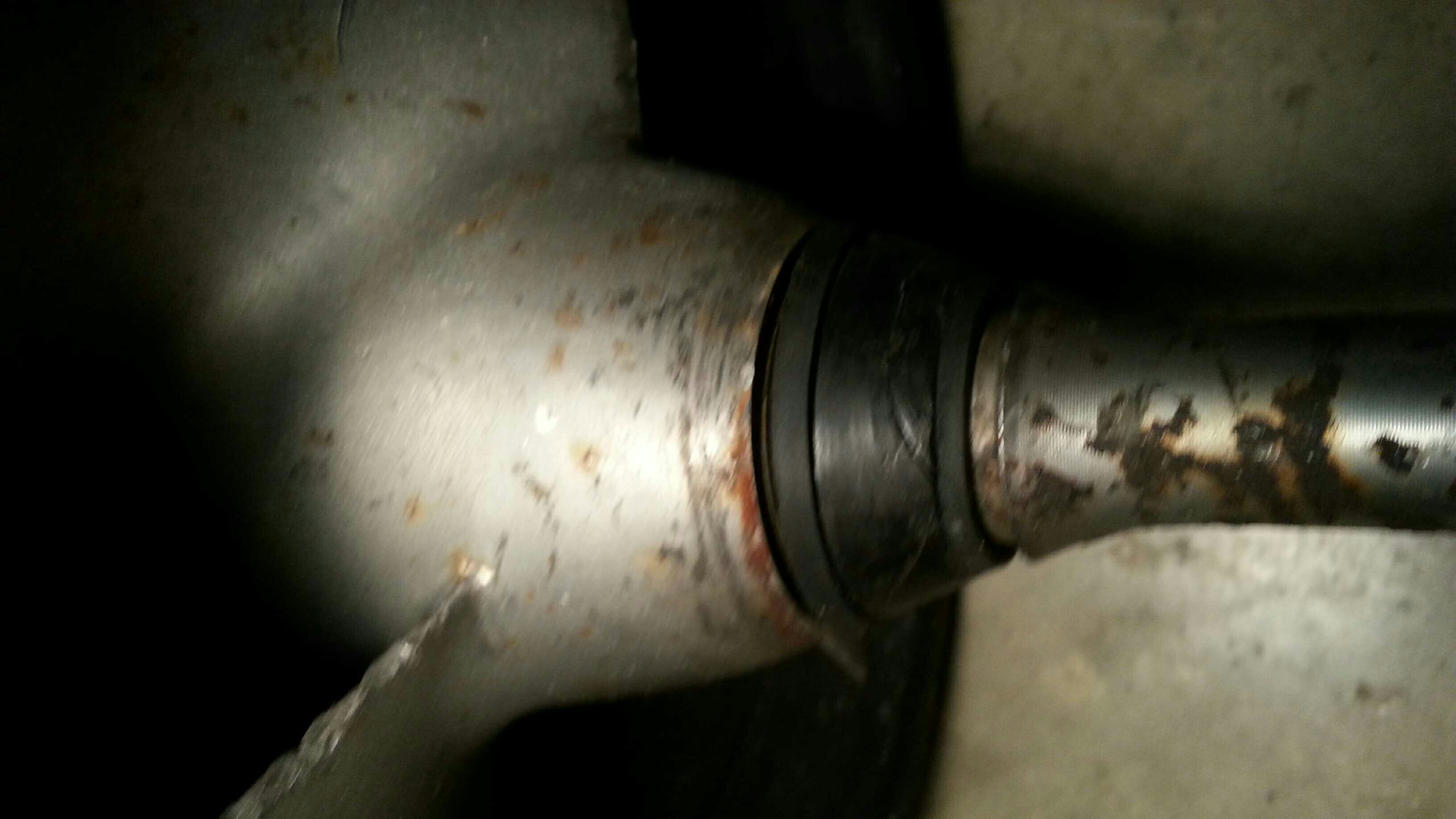

Just pulled jet pump tonight, wear ring is scored. Drive shaft looks good. Opened mpem which is dry thankfully. Here's a pic :
If it is gas and oil then why is there so much corrosion in the carb and air filter base.
Also the oil should not be in the carb or green as it is injected after the carb.
I would investigate that issue further before you start spending money on anything else.
Good question re the oil, will look into it further.

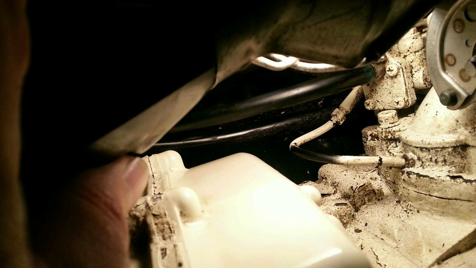

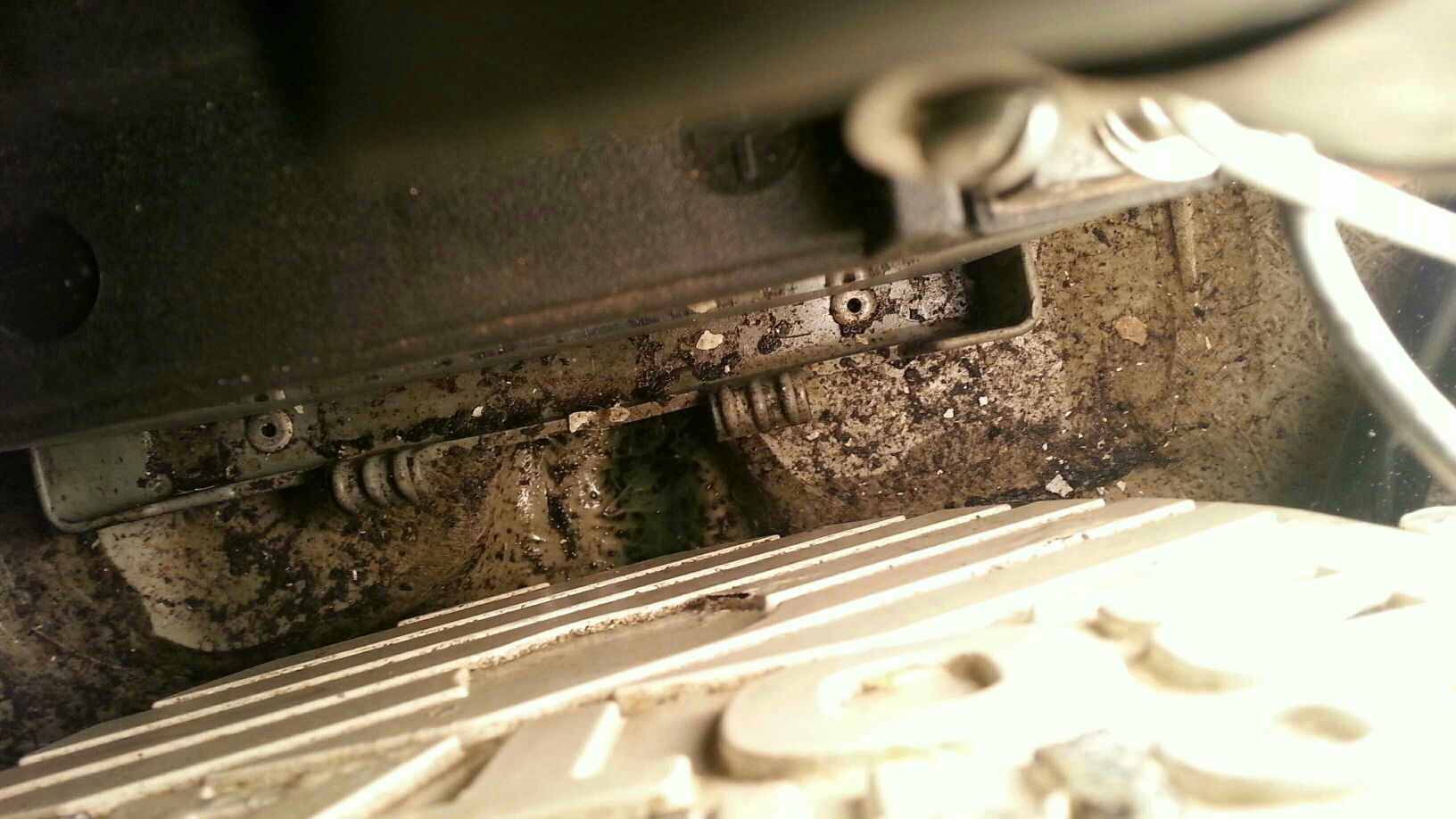

Have some oil that seams to be leaking possibly from lines. Hoses had some on it and puddle on inner hull. Is this likely from oil injector lines?
First pic I had already cleaned off part of oil on line, second pic is of blue oil pool on inner hull.
First off you need to drain and flush the oil system and install a new oil filter. The blue oil is wrong for a Seadoo. Use only API-TC rated oil.
Second the small oil lines from the pump to the intake need to be replaced with 3/32" Tygon hose.
The oil leak is typically from the grommet on the bottom of the oil tank or somebody over tightened the hose clamp cutting the oil line that runs under each side of the engine.
Castrol Super Clean in the purple bottle will clean up that hull.
