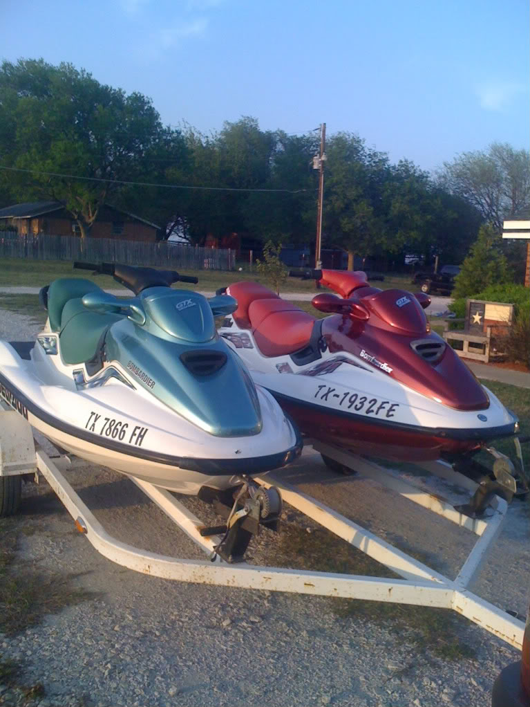

Here's what I ended up with...the green one is actually a GTI but I cracked the wind deflector and I bought one off a GTX...
