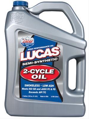

Finally, will your engine blow up using TCW-3? No, probably not but it is not the correct oil, does not lubricate as well and has been known to cause the rotary valve and inner crank seals to leak.
In the end it is up to you to decide if you want to save a couple bucks and try an oil that isn't rated for your Seadoo.
You can get the Lucas for $25 a gallon.
