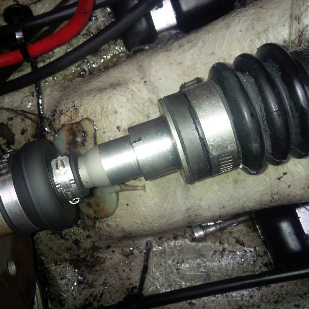

I inspected the cone and thanks god, there was not water there... only pure and clean grease.
Also did a "rebuild" in the pump parts, trying to remove corrosion and will paint in a few minutes.
Pictures:
image (36).jpegimage (37).jpegimage (38).jpegimage (39).jpegimage (40).jpegimage (41).jpeg
Okay...grease should be dark....clear...not opaque.
The second pic where you fingered the grease away from the bearing show's what that stuff should look like. The lighter cloudy looking stuff in pics 1 and 3 show water contamination. Get it all (the cloudy stuff)out of there. If you've disassembled the pump before and the grease is looking like it is now...means water is getting into the bearing. Gotta keep an eye on that or it'll only get worse for the pump.

The light green stuff is contaminated grease....in your post #18, first and third pic. It should look like the dark stuff underneath it...the second pic in post #18.
Is that a wheel bearing in your last pic?
