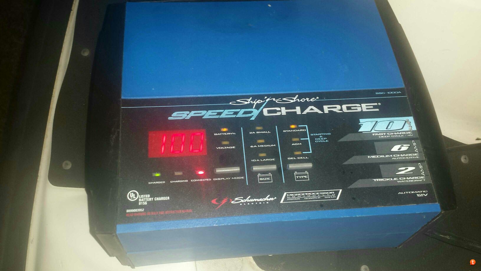

battery will say 13 V and charger says its good.
However once you put it under load................................ 9V and no spark :P
Mine tricks me all the time like that !!
Surface charge is 13 v, Actual usefull charge isn't enough.
