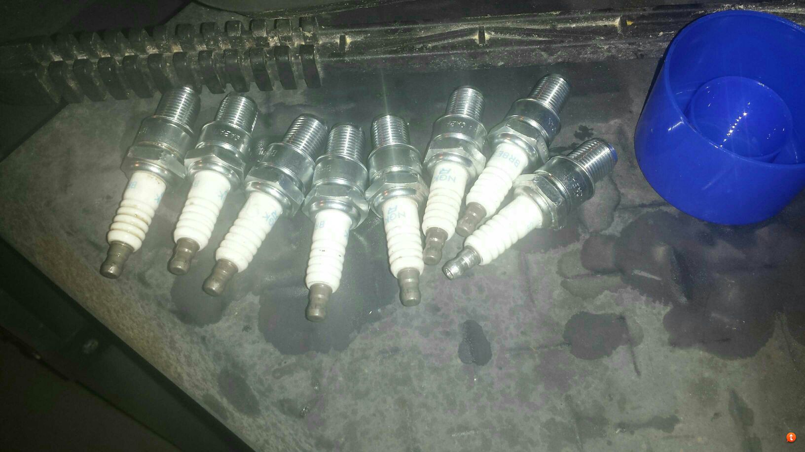

Well you need fuel in there then. Pour a little pre-mix in a small clean cup. I like the little cap off a spray paint can or similar(only pour the bottom full). Then put a bit in each plug hole, install plugs and wires and crank. If it bumps a few times and quits then do it again.

Still oily water? Put plugs in and try pourin fuel down the carb throats instead of dumping in the cylinders, maybe a little slower intro of fuel may be the trick

Strange.... Just keep goin, this thing is really a pain.... U can twist up a paper towel and shove it into the spark plugs holes to help catch the last bit of water... Don't put it in deep, just enough to cover the hole... Hold ur hand over so the compression doesn't blow them out... Then try fresh plugs and just a little gas down the carbs.... It's gotta fire if your getting spark

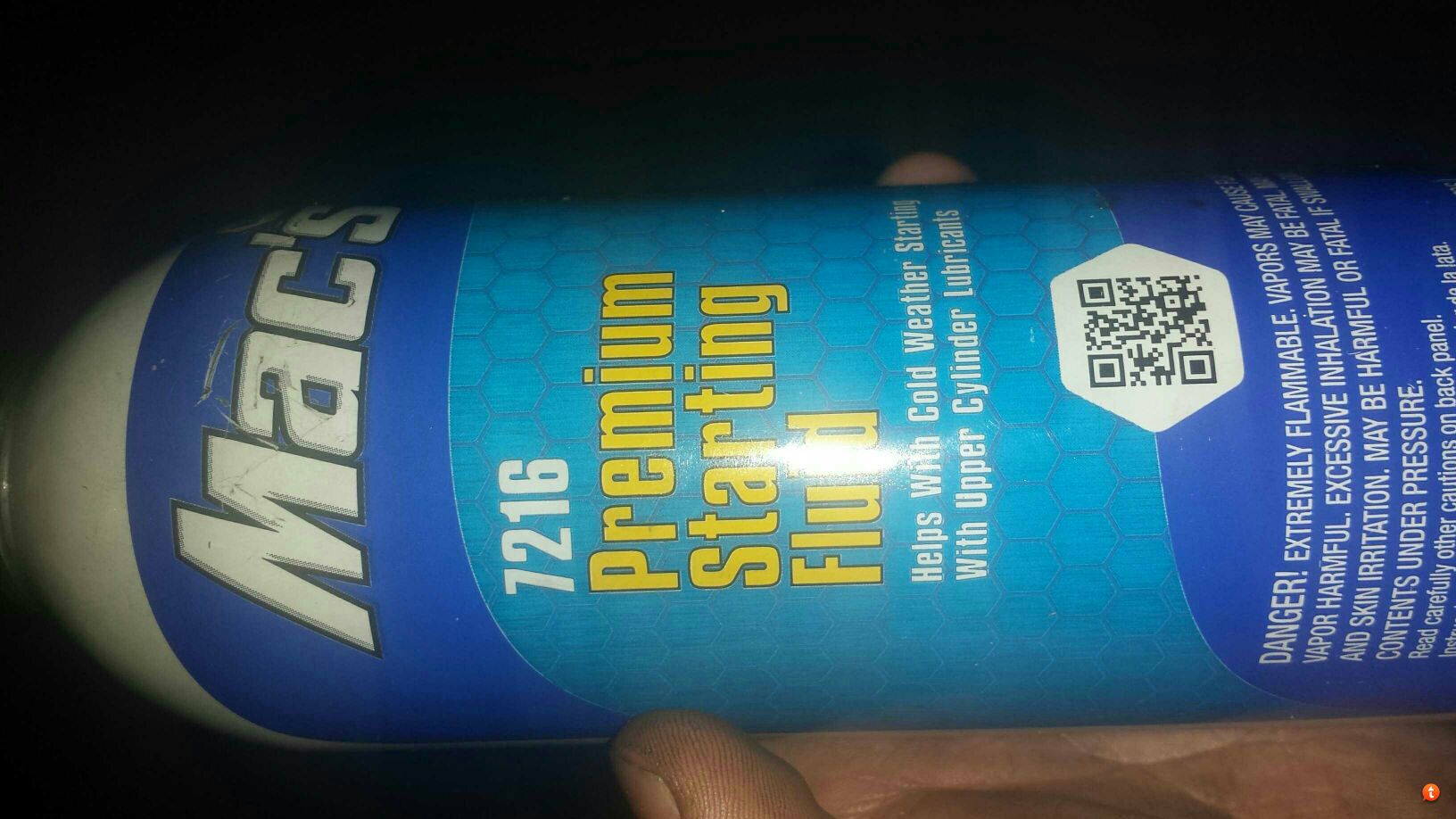

Run to the gas station and grab a can of starting fluid, give it a little squirt. I admire your persistence but your into day 2, its gotta fire up.

Two words---- Starting Fluid. If you have pre-mix in there, and the ski is running a oil pump, the oil is in there. A good huff into the carbs and let'r rip. Let's look at it this way, water will kill the engine, or starting fluid will kill the engine?? Pick your poison, I'm a betting man that the starting fluid does less damage than water will in the long run. You gotta stop pussy footing around. Most Walmarts are open 24/7, I know where you should be driving. :willy_nilly::rant:
