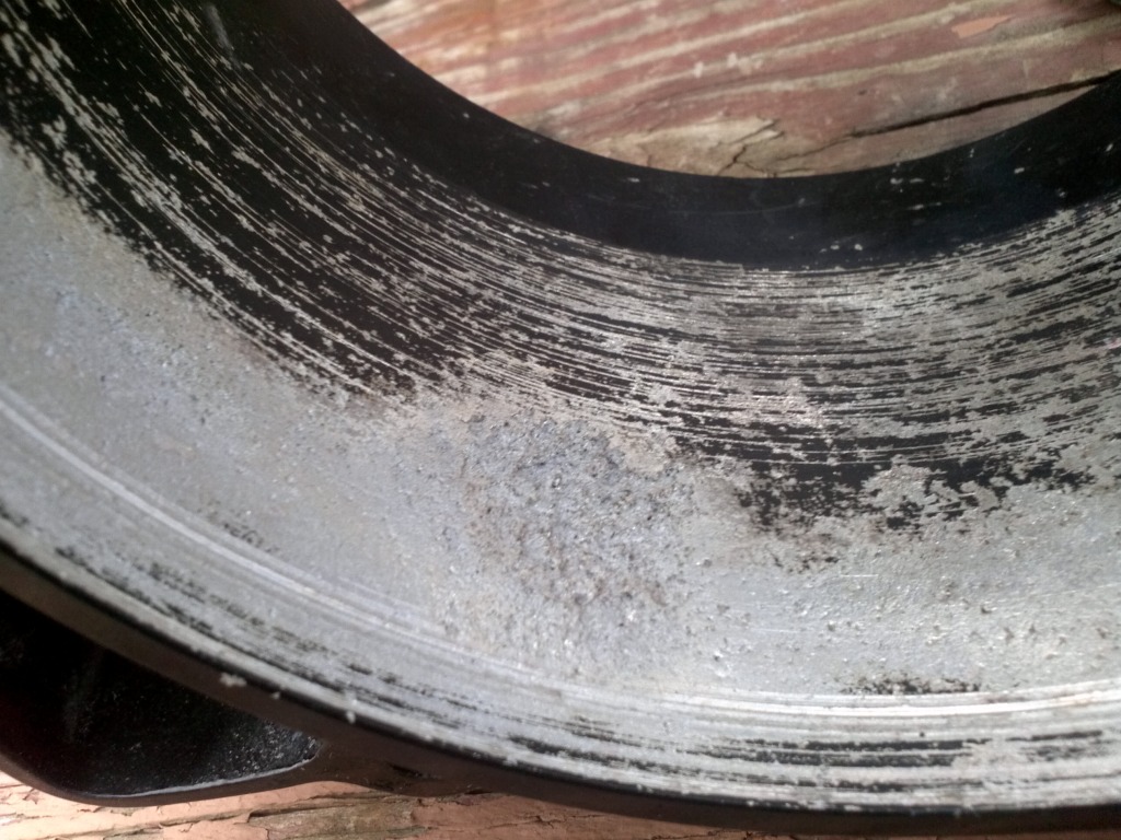

Hey im looking for some tools or will be making the 1 13/16 socket tool for impeller nut. I see that the tool is expensive and my local mercury marina does not have one. I checked it out because of a little sluggish on starts with boat half loaded. And regular maintenance.. i have some pictures i dont mean to double post but im thinking of doing the jb weld and doing the impeller at impros.com but wanted to see how the people that have done jb weld how it has held up? thanks

p.s there were never any good photos of finished product filling the voids in with jb weld i searched the forum hardcore.... also not any follow ups to see if it worked or worked for a little while and just fell apart. thanks the replace ment parts are sky high for these m2 sportjet components

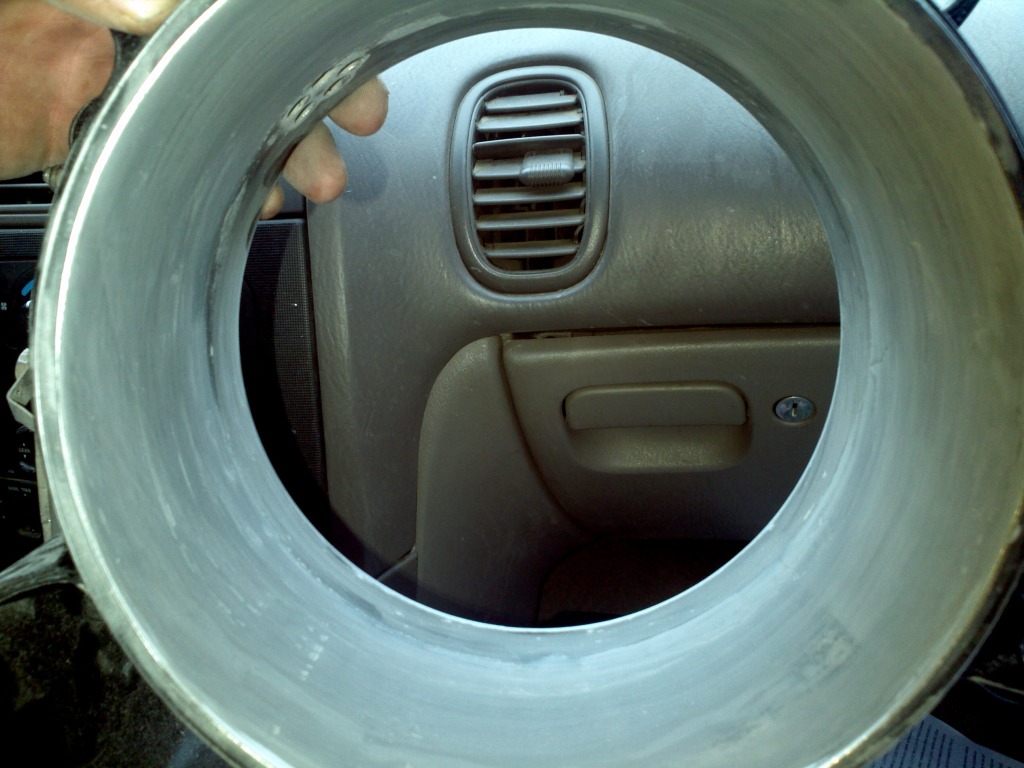

MORE PICTURES
Good job with the photos. I have seen other threads indicating the JB Weld worked just fine. Give it a search and good luck.

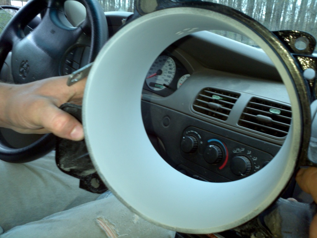

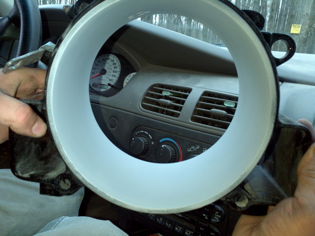

I'd do the JB weld on your wear ring first and maybe take a dremel and smooth up the fins on your stator veins. Your impeller doesn't look that bad to me. If the JB and grinding doesn't improve performance enough, then send your impeller to Impros. I think I've read their stainless insert just wears out the impeller faster. Let us know how it turns out.
I agree...i am cheap and would try it myself first...i think those stator veins really need some work too.
i missed your post sorry yeah i have a dremel i was going to send it out i dont know if i wanna pay the starting out at $105.00 if you guys think it only needs to get touched up. what do i do? just smooth them out or try to make them equal as i can?? thanks the impeller doesnt look that bad im going to finish the socket tomorrow i went to lowes and bought a 20 dollar 1-13/16 socket so ill have that off tomorrow and see what it looks and feels like.
I think your wear ring turned out good. You may lose a little paint where the impeller rubs down any high spots. I would just use the dremel to smooth out the leading edges of the stator veins.
ok cool thanks for the suggestions i will do that today the impeller does look fine to me to so after i do that ill put back together and refill the fluids and it hopefully should be close enough to new(lol). thanks again for your input i appreciate it!

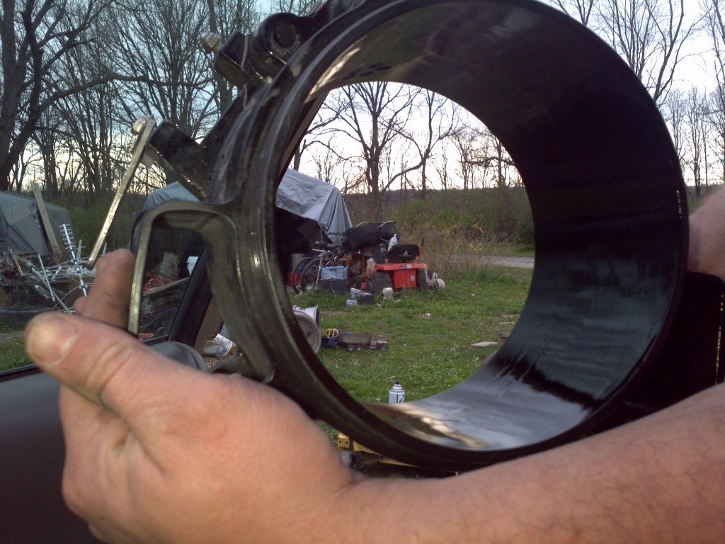

Koby, have you had a chance to get it back in the water for testing? What kind of resutls did you see?
I had it out once since and i still am not through my first 50/1 fuel mix for my break in period on my boat, so i havent gunned it out right. But it does feel cleaner more responsive and it looks to be holding up just fine, had it out for about 30 mins of run time so far. Got pump and stator fluids changed out with fresh rebuilt motor and wear ring i should be in good shape(knock on wood)

I'm just curious.... And theres probably a logical anwser.... But why are all your progress pics inside a car? Lol.

And lol just happened to have camera in the car.:hurray:
Did you measure your clearance between the impeller and wear ring with a feeler gauge before reinstalling? Just curious to see if you did and what you got. I'm redoing my wear ring right now. Nice work by the way.
no i had not retested but still performing well im going faster than ever 52mph
