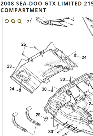

I am trying to replace the rubber straps for the Fire Extinguisher .... noticed a Access Door above ... it appesrs to me .. 2 screws and 2 c-clamps to be removed.
Will this disrupt much and am I on track of what to do? :)

Forum can be very helpful with good descriptions. It helps to put the year and model and not just GTX which has been made for the last 25+ years. Also helpful is saying that it is under the hood and not just a pic of a plastic part.
To answer your question for future reference for others:
Yes, under the hood where the 2 fire extinguisher straps are located, you can loosen the 2 8mm screws at the top on the upper plastic panel, don't need to remove them, and pop up the 2 plastic post pins on the left and right side to fully remove the pins, then the cover can be rotated downward and removed giving access to the back of the broken rubber straps for removal.
Touche' .... That makes sense ... the year. I was thinking there were c clamps, but found out otherwise and makes it easier that chasing a flinging clamp. Ha ... Thanks for the explanation of what I missed. Now .... onto my misfire issue. Ugh

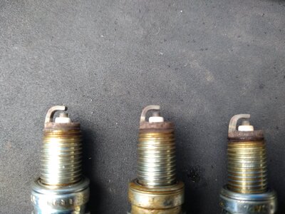

plugs... always check the plugs. by looking at the tip of the plug you can tell a lot about how your ski is running
is it a constant misfire? only at higher rpms? only hot? only when cold? only when in the water?
give use as much detail as possible so we can help you as much as possible
I noticed that too ... but I did just replace all plugs an gapped 0.30 and really haven't run it in water yet.
