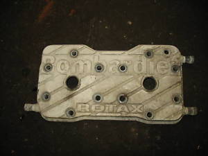

Since you said the hull has been repainted, you'll have to look at the engines. Here are some comparison pictures. Notice the 787 has a rectangular, flat cylinder head and the 951 has a rounded, domed cylinder head.

you can tell if its a 787 or 951 very easily by just looking at it... the differences are quite clear just by looking at the heads, you could possibly describe the two heads to the owner over the phone to determine what engine is in there... he's obviously a little lost... you really just need to know if the head is flat or has two round domes on it.
951 head
787 head
