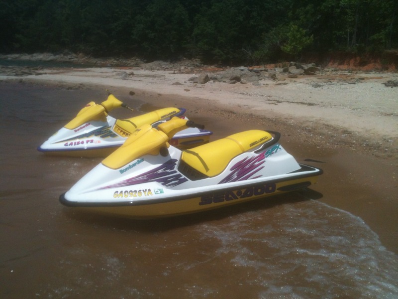

Finally got the 97 SPX out for the first time this weekend. Ran flawlessly....I couldn't have asked for better. I was a little surprised I didn't have more bottom end than my 95 XP, although the XP has an intake great and the 97 is stock. Lake was a bit choppy with holiday traffic to test top end, that will have to wait until next weekend. One thing that caught me by surprise is the HUGE sound difference between the 717 and 800 engines.
Thanks! The 95XP is like new...garage kept since the day I bought it in 96. The 97SPX (bought in October) is a little more road worn, but still in great shape. Hoping a buff and polish will get it close to the 95.
