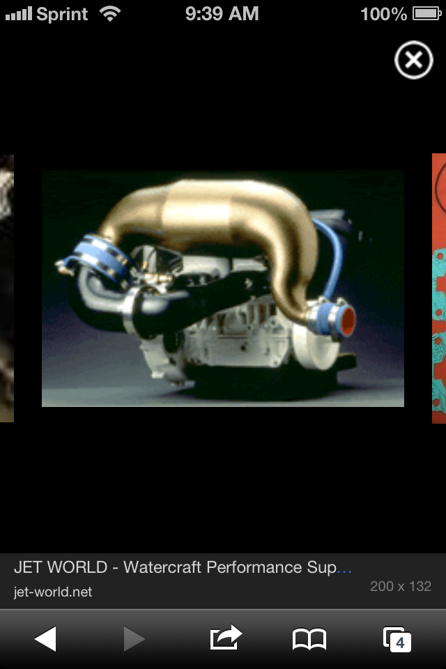

So I was thinking of putting one of these on my 95 xp and need some input... Anybody put one of these on a 720 and what were the results? Do you guys think its an engine killer? Would be a nice winter project and maybe add value to ski. 15 more horsepower and 5 more mph is promised. I am considering it. Any input guys?

There is a long trail of burned rear pistons out there due to these pipes being bolted on. To make the incredible power that they do it is going to require more fuel and ultimately shorten engine life. I'm shocked to here that they put out instructions that say rejetting is not necessary because it is. I would not even run stock 717 carbs. I would bolt 787 carbs at least.
It is a whole can of worms to open but there is a lot there to gain. If you want a milder pipe that is still a good one then get that Rossier pipe on there for $139. You could safely keep your carbs with that(just open the HS needles and watch plug color). The ecwi (electronically controlled water injection) has a lot to offer every two stroke exhaust system. It really makes it snap off the bottom end.
So your sayin to bolt on a set of 787 carbs stock( with jets and needles) set for 787 use? What about a set of 787 with accel pump? I'm still considering it. Won't the 787 carbs flow too much fuel(too rich)??? I def appreciate your very experienced in put Matt. Thanks. Keep it comin!
Add the promised 18ish HP to a 85HP 717 and your right at what a healthy used 787 is putting out. I have not adapted the 787 carbs to the 717. I have always had a aftermarket set that I got with the matching intake manifold for $300 or less(I shop the forums everyday and try to be first).

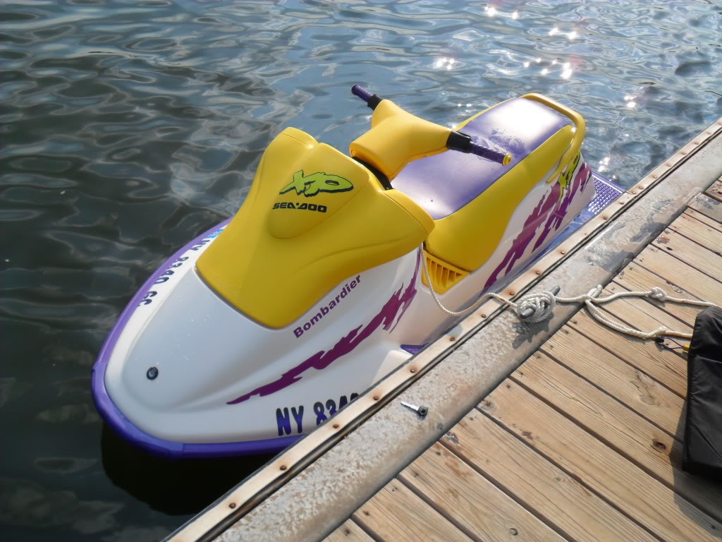

Well Lou I got a 97 spx with a 787 and I luv it but my 95 xp which has some sentimental value to me and I've never modded a seadoo. So I was just thinking about it as a winter project. Something to work on. I did not ride the 95 xp not once this season because my spx ran so awesome! So I was thinking of givin it a little boost. 95 xp is a great ski and I feel like its got more in it.
Nice ski. I once owned an 95XP it was the first ski I owned, and I remember thinking at the time, this ski is perfect. I still believe that. The 95XP has the perfect balance of power and hull and it was also the most reliable ski I ever owned. It never let me down, I sold it and bought a 96XP which was also a great ski. But I sure miss the 95XP, my advice KIS (keep it stock).

I have tried the APE pipe and they are good also. They have a good bottom end improvement but are not as good at revving as the Factory pipe. They are heavier and fill up the engine compartment more.
With the lighter weight and the pump extension a 95XP with a Factory pipe will out run a stock 787 X4.
Modding the 717 is tempting but dangerous. It has pistons about as large as the 787 but with a shorter stroke. With this and the reduced mass from a smaller crank and the lack of a counter balance shaft....you got a peppy little revver.
It is dangerous because a 717 is really maxed out already. It is basically the white 587 just enlarged but pushing out 85HP rather than 50. See that bigger pto on 717's? That is an attempt to keep the crank bearings cooler and have them last longer. If you put a tiny pto on it with that water injected Factory pipe you can't even keep the ski under your but. But like Lou says....you can throw reliability out the window.
