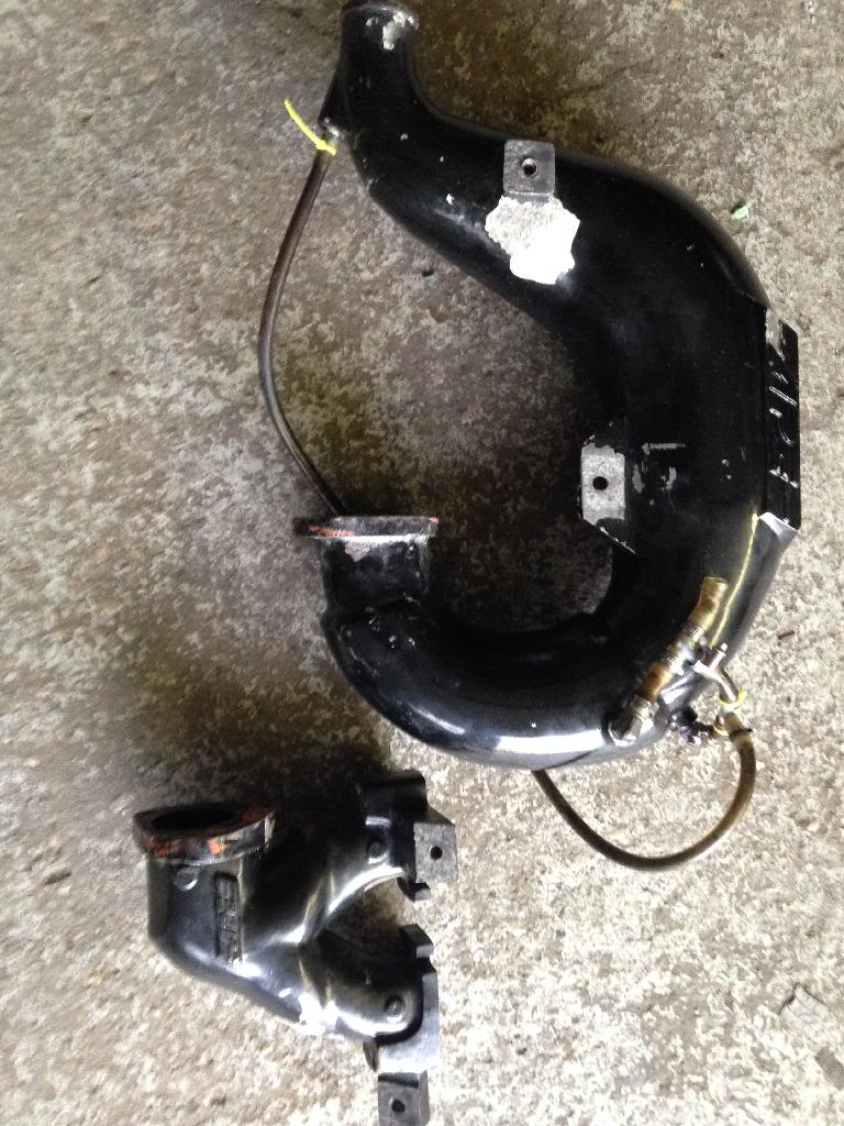

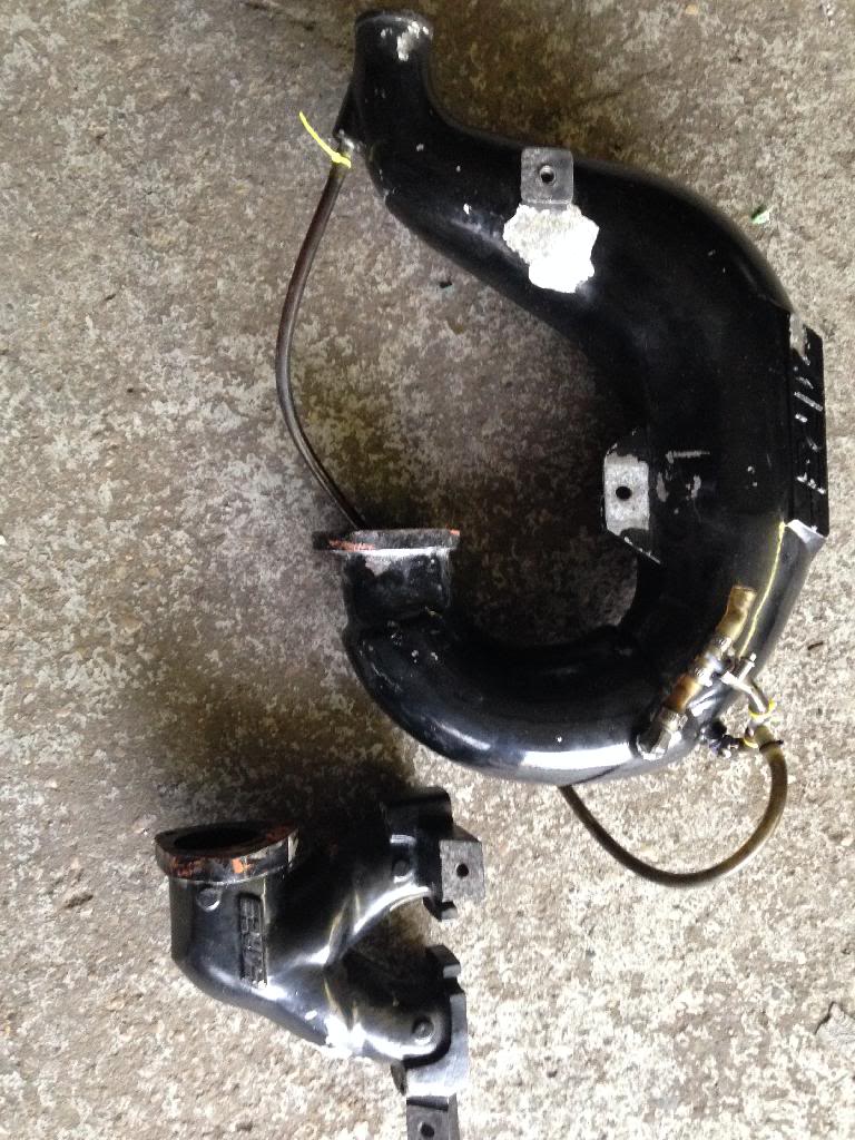

I don't like the rossier pipe. It's just not sexy enough. It doesn't look good at all. I got the APE Pipe because it was in good shape and within my budget. It does not have water injection system but I just might add it. What do you think Matt?
I think you should try it without ecwi at first. That pipe has a good hit on the bottom end as it is. Pick up an extra 6mm allen wrench to sacrifice. You will need to cut one down on the short end to be able to reach the inside bolts.

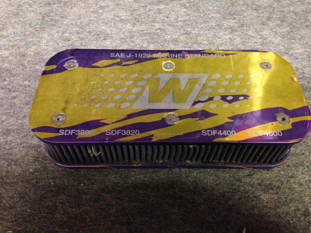

Ok so I also got a smokin deal on a aftermarket flame arrester to compliment the APE pipe. Here is a pic ...
So Matt braley I know I am gonna have to either rejett or lower pop off to go with APE pipe and aftermarket FA. Any pointers Matt???
Very nice. Those have good velocity stacks in them. I'm hoping the bosses to mount the brace are on the other side though? I say this because unsupported carbs on a modded 720 are known to crack the case.
I would lower the pop off and re-jet. Probably 70 lows with a pop off psi between 30-35. If you don't up the HS jets then I would start with your HS adjusters at 1 full turn out from closed. Then you can record rpm and check plug color to dial it in.

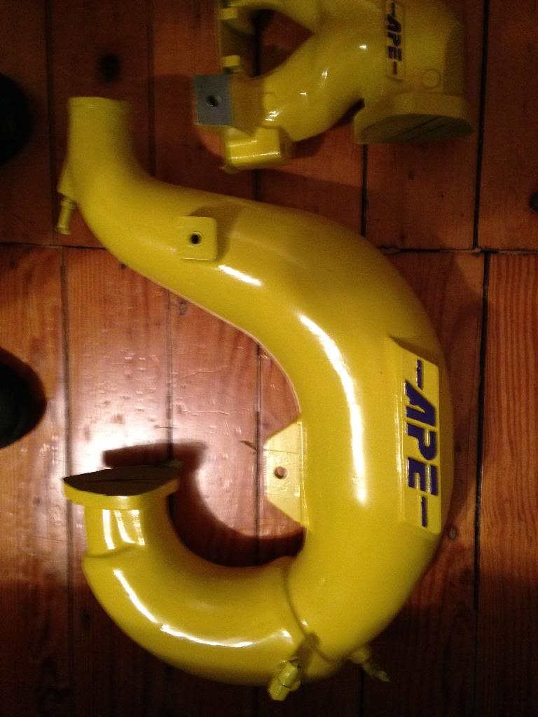

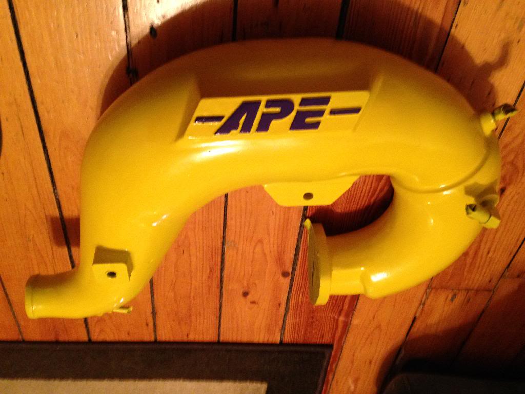

Ok so I bead blasted pipe clean an primed a painted with VHT high heat engine enamel. It's finally finished. About 3 days of work. Hey Matt just to be safe I got 70 pilot jets and 140 high jets to use with pipe. Here is a pic. Let me know what you think!
