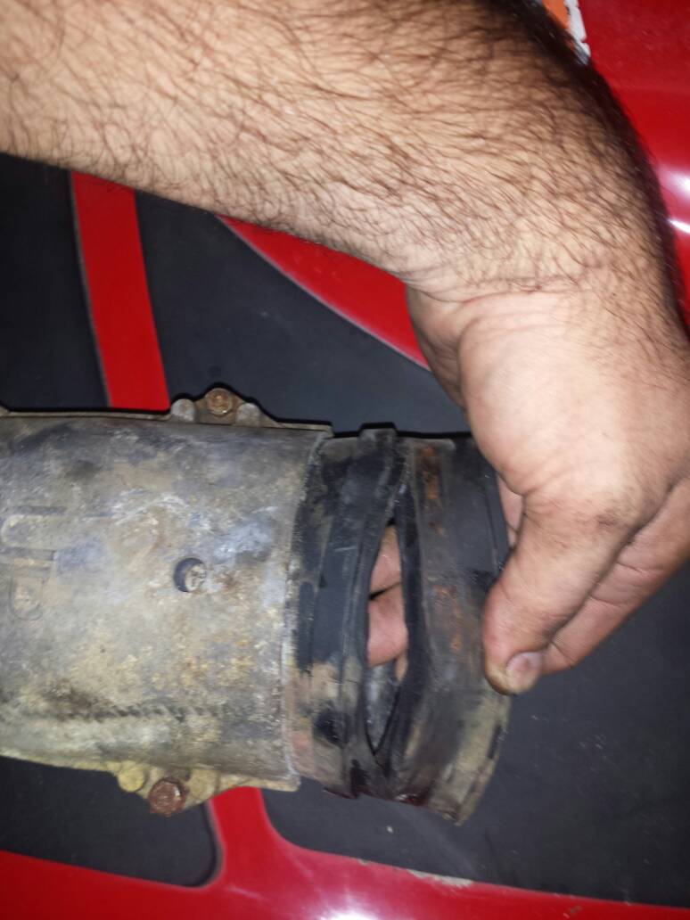

Then I found a guy with an 2003 yamaha cruiser. He flipped it and turned it over the wrong way. He couldn't get it to run right. Totally sick of it sold it to me for 1400. I noticed exhaust leak and changed oil, filter, and plugs and it's running like brand new. AND I SAY, THE HELL WITH SEADOO AND 2 STROKES IN GENERAL. No offense to all of you who have helped me along the way. Much love.

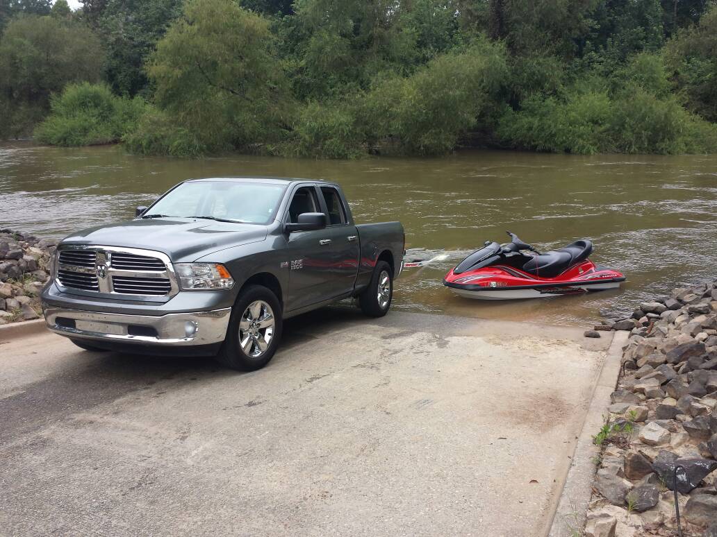

If beaching your new seadoo on the concrete ramp is how you take care of your doo's no wonder it isn't running lol
No brother. I keep up with maintenance, and keep my skis in immaculate condition. And btw there is a thing in south Georgia called sand. And guess what? There's sand right there.
There is an elbow that gets plugged with sand in most 2-strokes. If you follow the flush line forward, it will be the one right near the head. This causes hot spots and can easily harm an engine. It needs flushed every time if you do the beach thing. Flushing runs the water in revers, thus dumping the sand that will normally be trapped there..
Funny guy. .. Some phenomenon called current brings the sand from up the river, and this concrete ramp here happens to be around a nook. Now what happens is, the current actually flows through here bringing sand, and the sand builds up right there. It truly is amazing. Maybe you should take a trip down to south Georgia and I can show you all about it!
