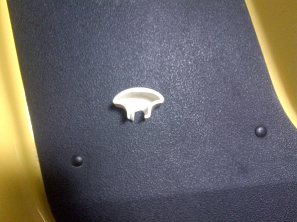

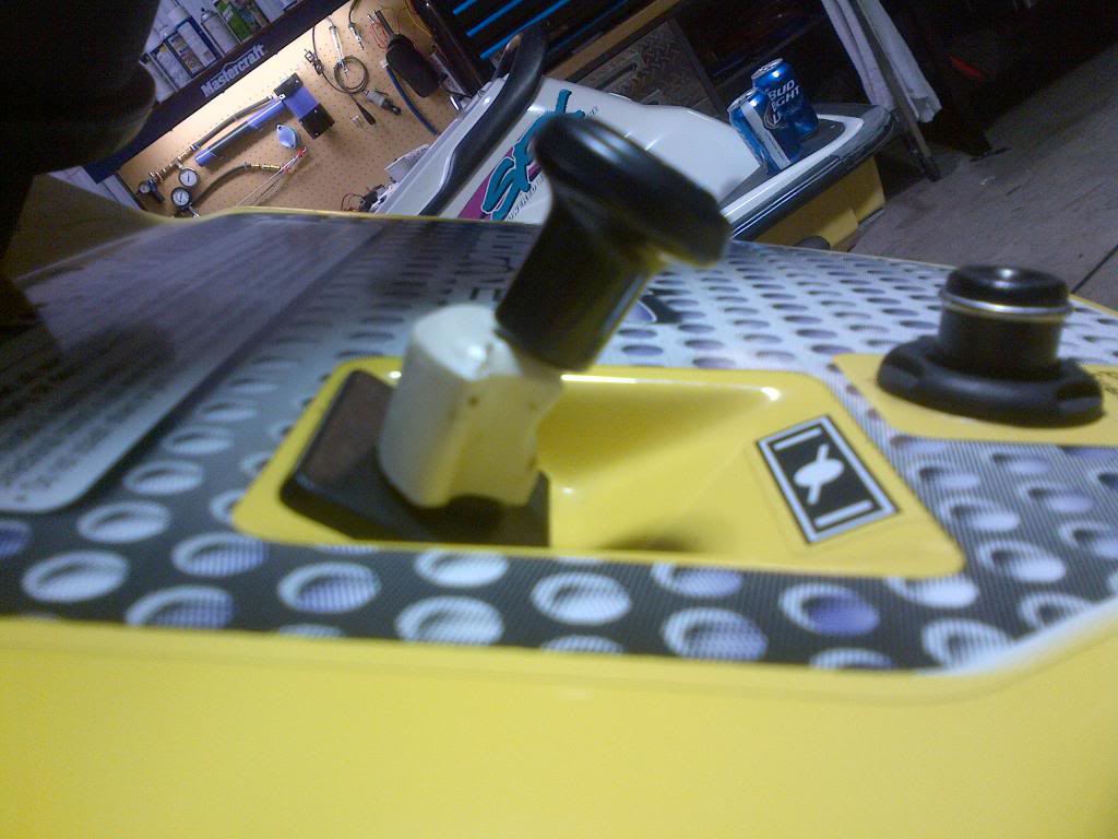

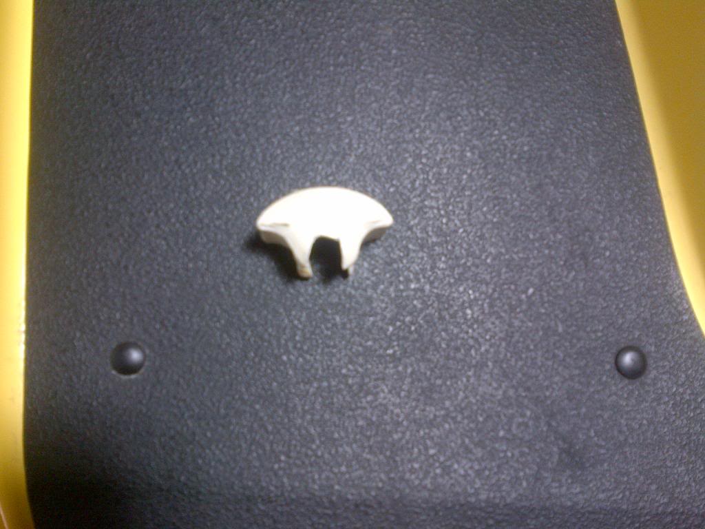

I made a little gizmo to help with the whole, throttle, choke start button thing. I took an old fuel float and cut it in half and notched out the center to go around the cable when the choke is pulled. holds it in place perfectly and even has a little grab handle to pull it back out easily.

I double checked all mine and none of them will lock, hence the invention.
the old rectangular button ones do it from the 90s but the round button ones don't, at least thats been my experience.
