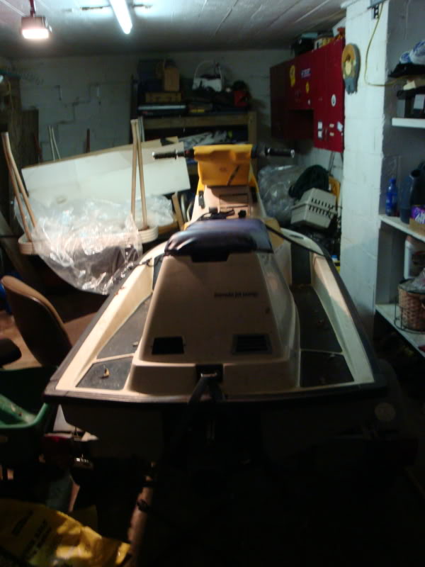

Here's what a $1k pre-96 looks like. (that's prime $$$ for an old ski, and that's with a very nice galvanized trailer)
Clean? more like EXTRA CLEAN TO IMMACULATE! I've only seen one other ski as nice or nicer than this one, and its because it sat in an old man's garage untouched under a cover for 13 years,(but then you get into issues like dried out seals and gaskets and dry-rot)
But yea, well taken care of, Doc!
Nice looking SPI Doc, that's for sure. My '90 SP looks almost identical except for my handlebar cover and front plastic cover are blue. Mine sat in storage under a cover for quite a while as well, so still looks pretty good besides a small tear in the seat. Im thinking of a color change this fall/winter... I'll post some pics of the progress.
BTW, whats the difference between the SPI and a regular old SP?
Can't see much difference, Doc... ROFLMAO! Looks nicer than what SeaDoo did when they made it new!!! WOW! Nice job!!!
