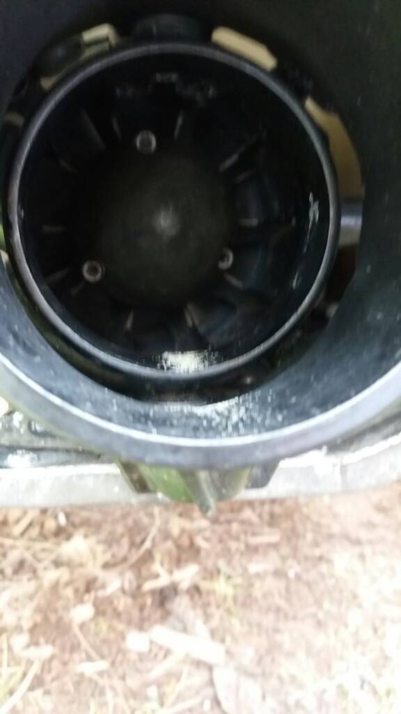

Meanwhile, I can address the water refraction issue in the steering nozzle. The footage I took was not quite on plane, or maybe just barely planning.
I wonder, what if I bore out my steering nozzle? I have seen some that are not a nozzle at all, but rather a wide tube. What are the pros and cons of widening a steering nozzle?
Steering nozzle measures 86mm, while the reduction nozzle I bored to 84mm. I'll definitely be boring it out.
Is there a benefit to having the steering nozzle narrower? Why not just have them all bored really wide to ensure no additional resistance?
If they were way too open you wouldn't get much thrust from the jet there would just be lots of water being pushed out.
Think of a garden Hose pipe, with nothing on the end lots of water comes out but with very little pressure, put your finger over the end and suddenly you have loads of pressure or in the case of a jet drive propulsion.

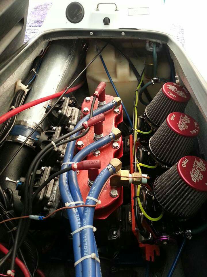

Yea [MENTION=83161]beerdart[/MENTION], that looks like a whole lot of fun. Does it spin around like a stock X4, or do you have the rails bolted on? I've been trying to perfect the true 360 (where your nose ends up pointing in the same direction) It's fun as hell, but I'm still too much a wimp to cut it full throttle, and that's about what you have to do.

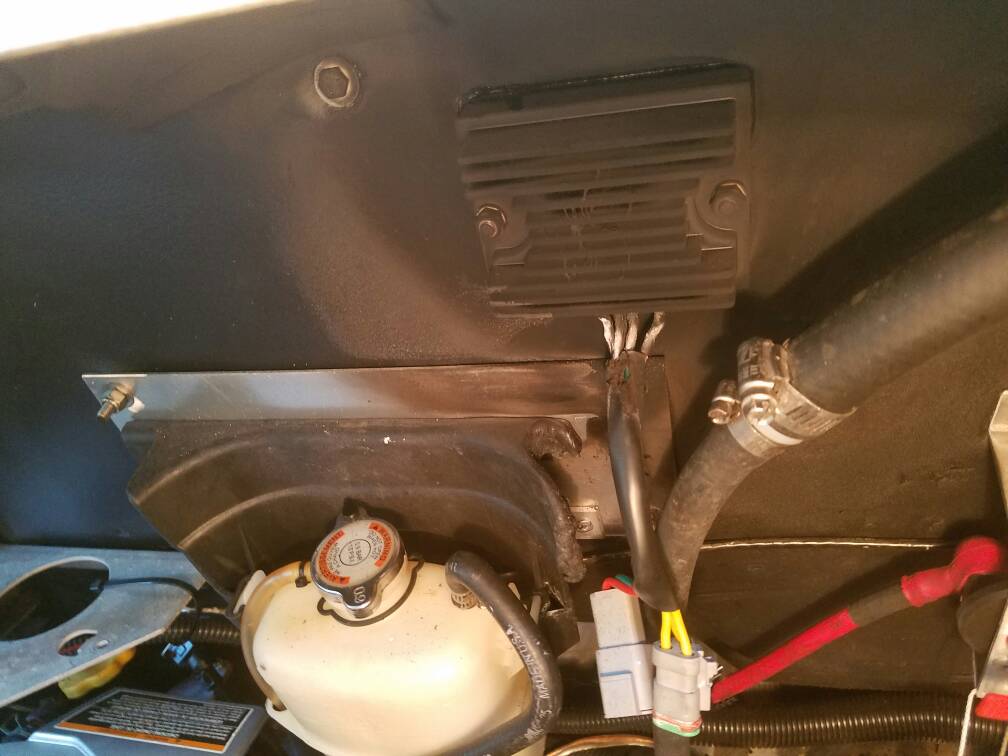

Update: got the new rectifier/regulator in. It's a nice, beefy unit. Heavy and seemingly very durable. Rated for 32A, it should be able to take the full brunt of what my stator has to throw at it. I need to think of a new place to mount it, where it can both breathe, and not catch anything on fire. The most optimal place would be in the air intake tube, but it's plastic, and if I ever have a repeat of what happened with the other rectifier, I'll melt the tube. At least I'll be able to smell it quicker.

Tested the new rectifier. Got around 13v at idle, then 14.5 at 5k rpm. Proceeding to mount it in the plastic air intake tunnels. Going to put it on the port side where I don't have the Styrofoam block that can catch on fire. In the event it fails, molten plastic can rain down onto the 5/8in thick fiberglass that forms the bottom of the boat and interfaces with water. I should be able to smell it long before that. Besides, I'll have the volt meters and instrument cluster to warn me of any trouble.
I was going to say that on a 4tec it is mounted in the air intake, you might also consider mounting it in some kid of plastic box with a 12v computer fan blowing on it, anything to dissipate the heat
I thought about putting in a little fan, but deemed it too much trouble. This is a better unit than even the oem, which, until my blatant abuse was doing just fine baking in the heat soaked engine bay. This unit, being in the air intake duct will have air moving past it every time the engine is running. Besides those fans are not water proof, and I'd have to come up with a way to make it run while the engine is running. Too much trouble for little gain. I think getting it out of that engine bay is the biggest improvement aside from moving it away from the fuel tank lol

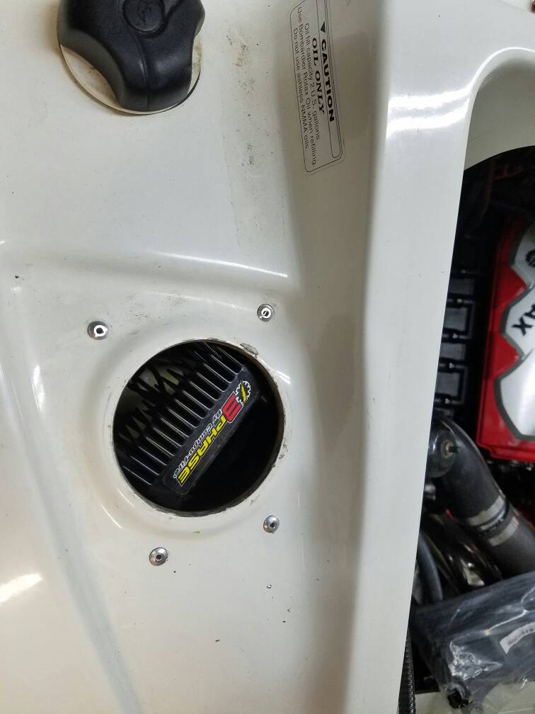

So I finished relocating the rectifier and running the wiring. Had to pull it and sheath it in different parts of the loom but the lengths worked out perfectly. Here it is in its new happy home

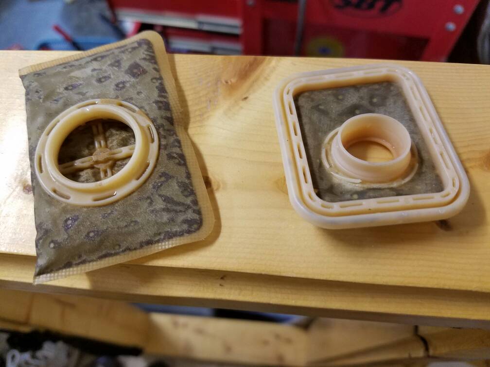

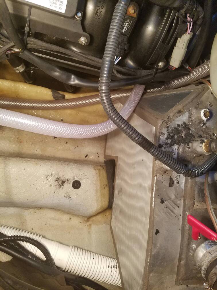

Having finished that I moved on to the very troubling inability of my boat to pump fuel when it gets below 1/3 full. I thought that maybe the baffle was losing it too fast somehow. When I opened it up though, I found the opposite problem. It couldn't fill itself fast enough. I checked the fuel pressure and got a prefect 45psi every time. I pulled the pump and attached a length of hose to the end. With it plugged in, I attached the key and watched it pump fuel at various levels of submersion. At 1/3, it was barely sputtering.
So I took off the two fuel strainers.
There is one inside and outside the baffle. They were both hopelessly clogged. I don't know how the boat ran as good as it did. The strainers held water!
Jetski plus had them both for 20$. They're on their way.
