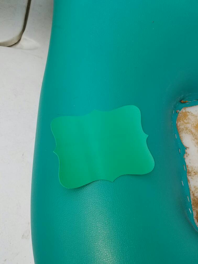

I'm really starting to worry that I will not be able to find the right color of vinyl for this boat. I have searched every single retail store on the internet. Nobody has this color of Teal. And looking at all the rest, I realize that this one is the best teal out there. I'm puzzled over many of the colors I find. Who would want these boring dead-body hues on a BOAT?? The old seadoos had such an awesome color, why is it not available?
I spoke with Keith from Seadoo upholstery, and he seems to know what color it is. But looking at his site, the color of the challenger in his pic is of a different teal. It too is one of the more blue ones :(

Ive got one of my seats in my truck that is a greenish teal from zzauto and when i took a pic it looks blue but is definitely green20160429_141804.jpg20160429_141838.jpg one in the sun one in the shade so probably not much help but it is greener than the foto does justice
Wow. The camera hates "aqua teal" from zzauto. The orignal was dark green same as 96-97 GTX we had back in the day and doesnt have quite the same effect on the camera. It is probably some shade of blue but it looks greenish20160429_184419.jpg20160429_184401.jpg20160429_184352.jpg
I noticed that the 1800 challenger vinyl is s darker green than the 110.

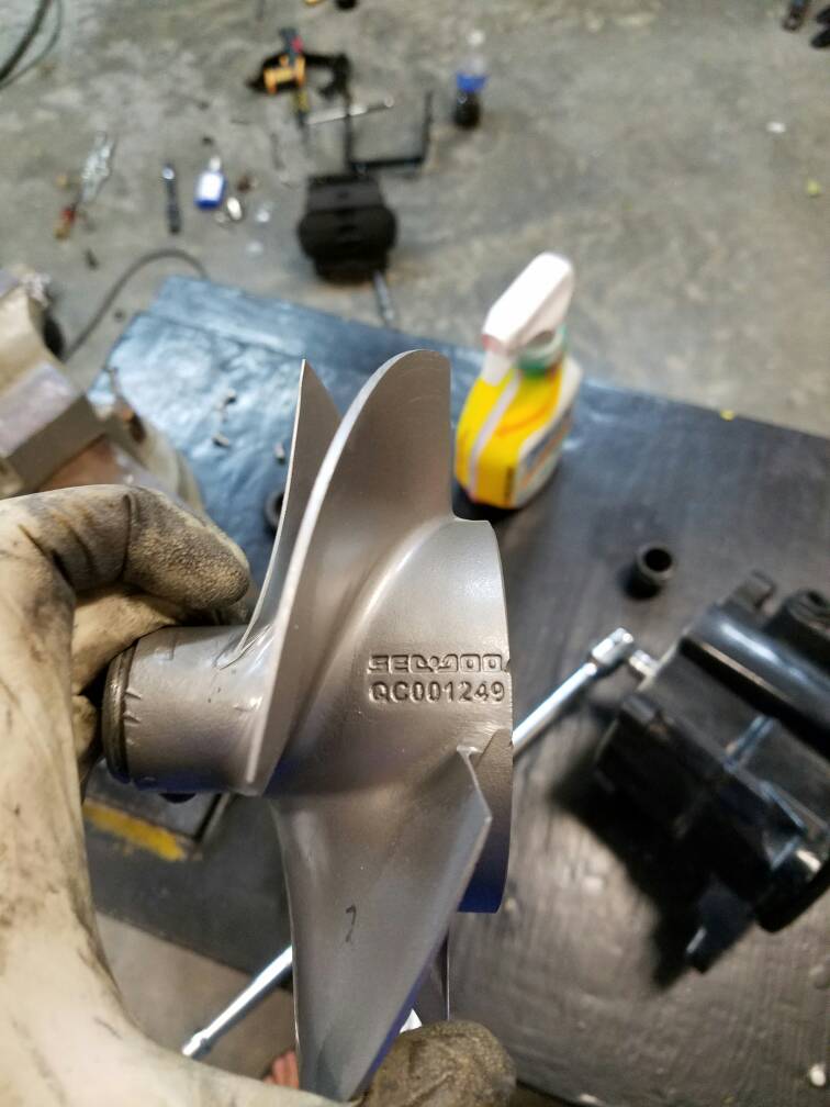

Today I popped of the impeller and would you look at that cavitation rash? After only 1hr..
I knew it was bad, must have been a constant thing.
I verified pitch using my pitch gauges. It appears to be around 12/20 or 13/21.

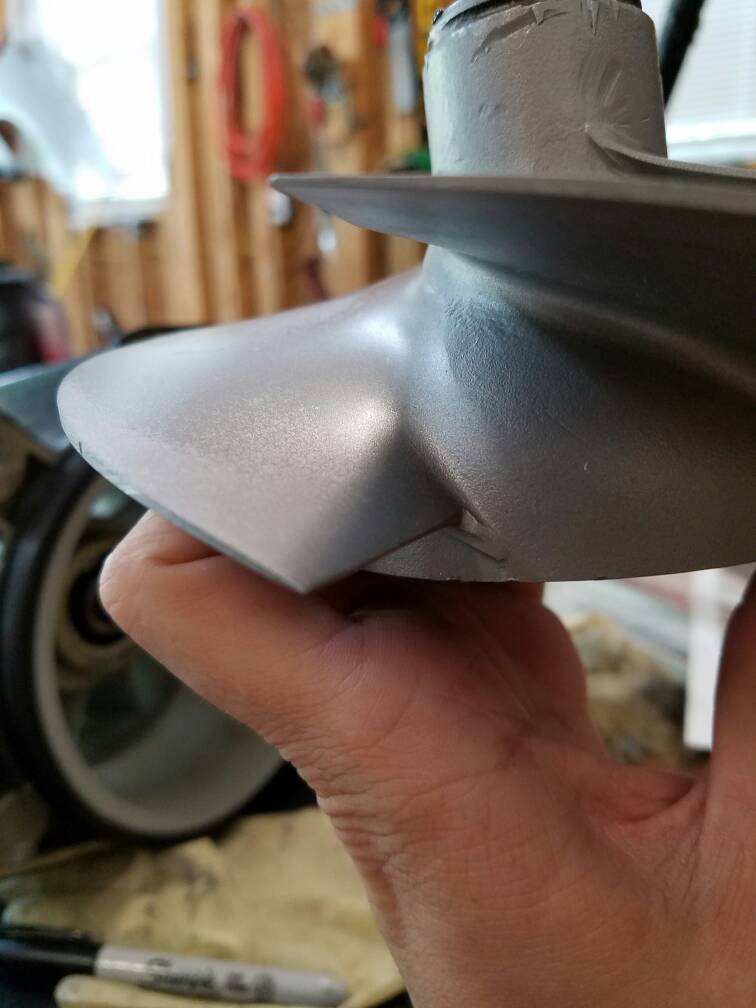

I had to correct a few of the blades, as they appeared to be not uniform with the rest. Also, it appears sbt sent me a gtx 155 prop, not the sc.
Also, it seems that part of the trailing edge was cut off.
There is hardly any overlap in the blades...

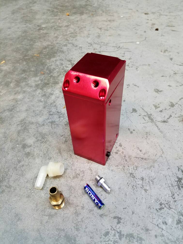

Got the new carbon seal installed. Also going to finish setting up this oil catch can. The dip shits on ebay falsely advertised one with larger ports, but sent one with tiny 3/8 barbs.

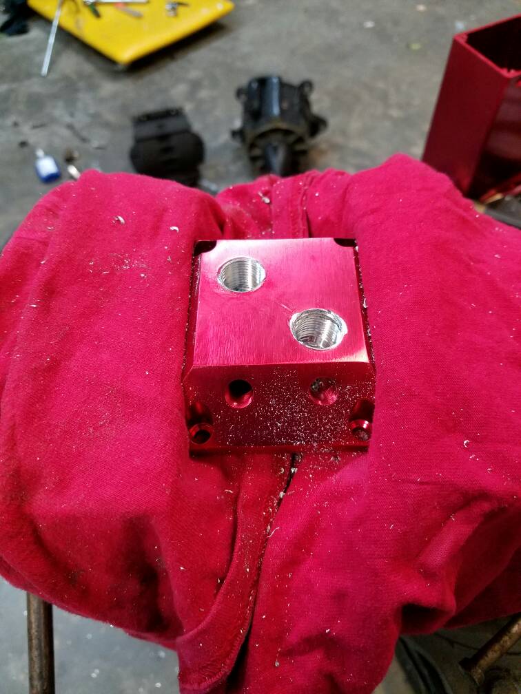

Had to drill and tap it for 3/8 npt thread. Lucky for me I had the tap from my days putting fill holes on 787 balance shaft chambers.
I'll go by h depot and buy some 1/2" I'D FITTINGS and see how it does. Hopefully I won't have to invest in more drills or taps, those are $$$

That prop looks real funky. Any cheap ones on Ebay you can grap or surely someone from the classifieds has one they would let go real cheap. I've never seen a prop that didnt have the blades go to the base of the hub. Wonder if that's actually how the prop came from Seadoo or if its just another SBT hack job.
Well good news: I contacted SBT and sent in the pics of the impeller and the short trailing edge. As always, they were very responsive and professional about it. I dealt with Cesar, and after inspecting the pics he agreed that something didn't look right. He's sending me another OE impeller to compare with, and if the new one looks right, I'll send them back the old one. Now mind you, this is 2 years after I made this purchase, so HUGE props to SBT. I go through them quite a bit for all my boats, and their customer service has always been spot on :)

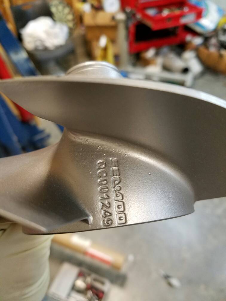

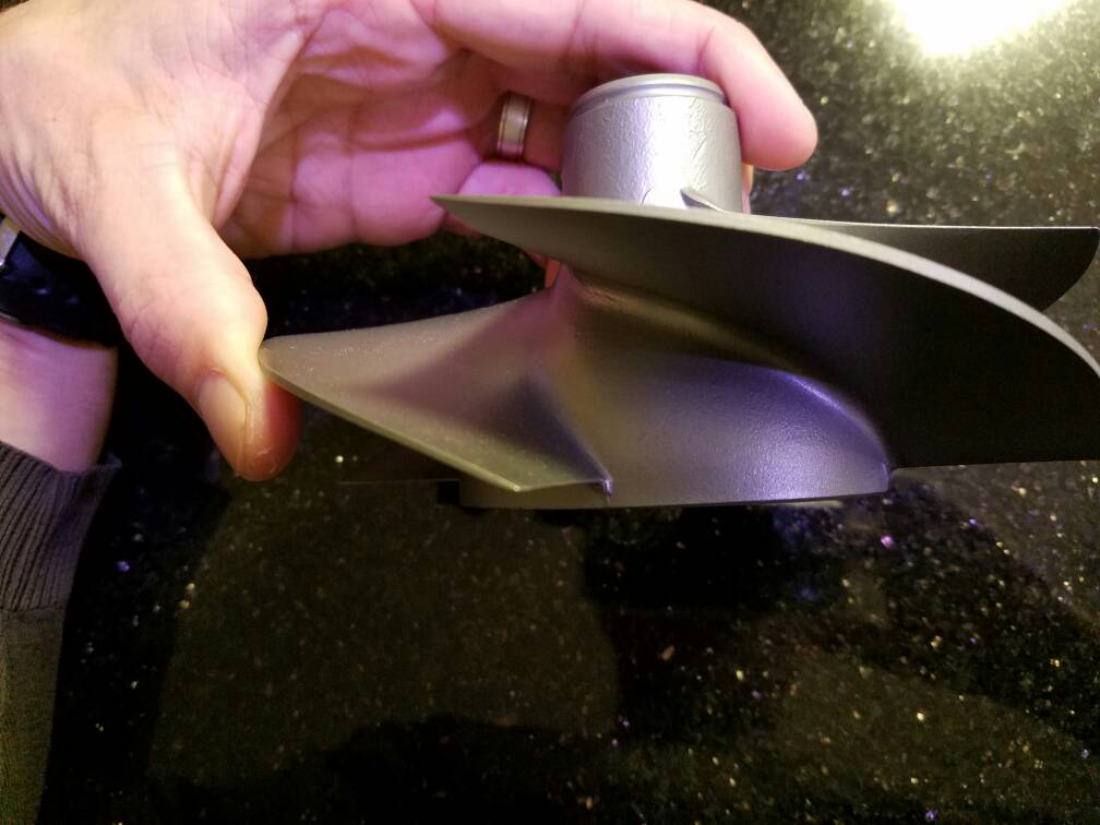

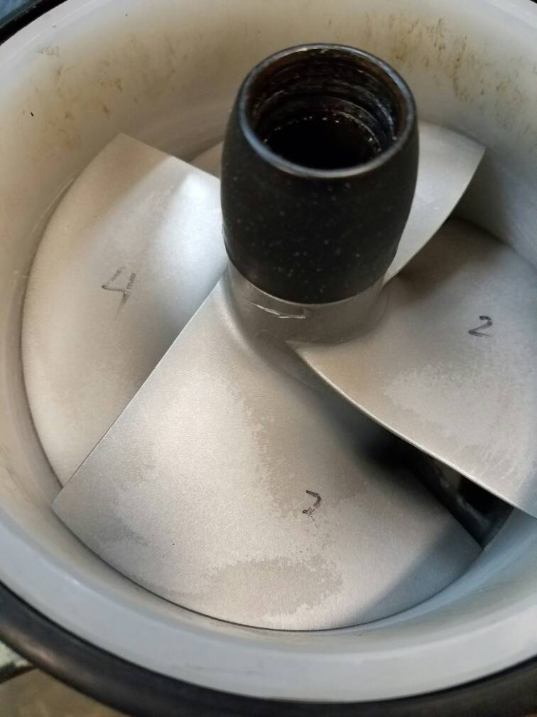

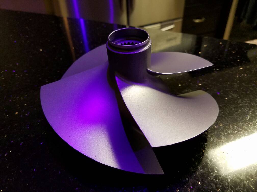

Got the new SBT reman prop yesterday
, the trailing edges are perfect on this one.
I had the party lights on over my bar, made for some cool photos :)
The old one must have been a one off anomaly, the pitch and blades on this one are mint!

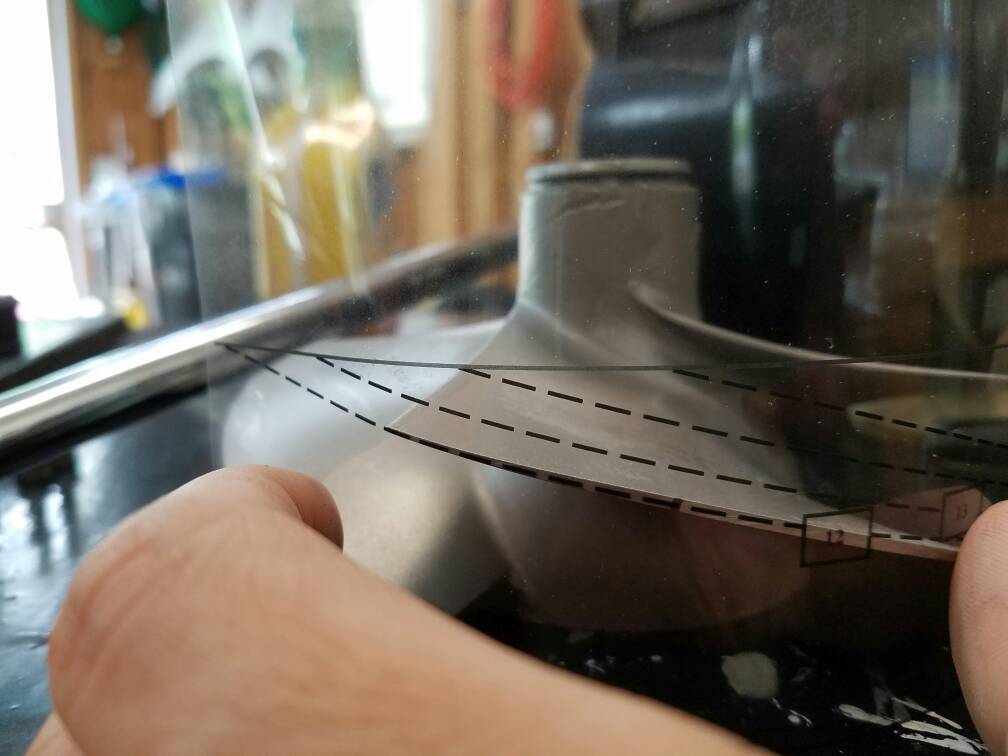

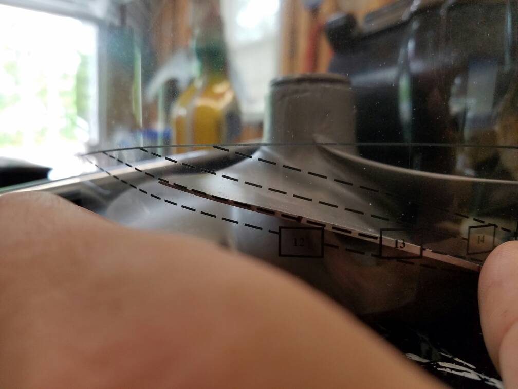

Looks like an 11/20, measuring from 1" off the edge. At the edge, the marks don't line up with any degree line. Going to try it out tomorrow.
Keith from seadoo upholstery got my seat back upholstery to me already! I couldn't believe it, I placed the order At the start of the week! It looks really good, and the color is almost an exact match. Good job and thanks Keith! Can't wait to put them on!

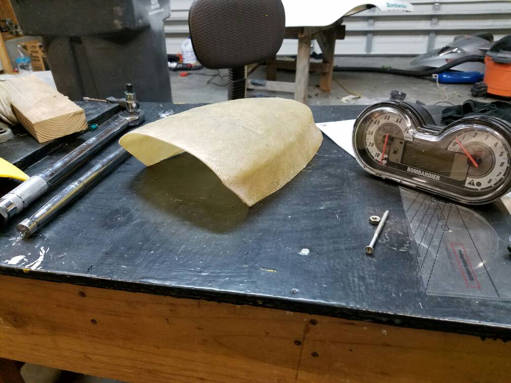

The meet up is right around the corner, and there is still quite a bit to do. I started the dash gauge pod, but am not sure how well that's going. It is really hard, perhaps the hardest part of this whole project. Not sure how well it'll turn out, and I might have to redo it, but I need something for the meet up besides a duct taped gauge cluster.
Boom, that's what a prop should look like! Can't wait to see if that solves the cavitation issue. Seems like it very well could. Crossing my fingers for ya.
Well, the new prop is a big improvement, but strangely, it seemed to cavitate less when I first got to the lake and more as the day progressed. I'm still turning 7600 at wot, but I don't think in cavitating at full speed anymore. Might pull it and try going up a degree.

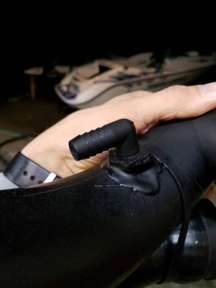

Also this was the first time I hooked up the oil catch can to my intake. No pressure buildup whatsoever. Engine ran great.
that's the barb I epoxied onto the intake for the pcv.
