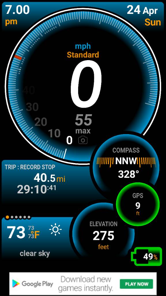

Max speed recorded on the main gauge [emoji3] I'm happy with this speed, now if only I could get more hookup and holeshot
