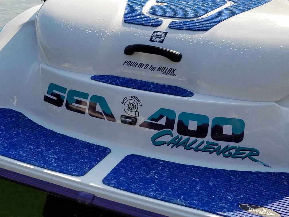

Just got back from an awesome weekend with the forum crew on Lake Norman. The 2016 members unite meet up was AWESOME! So many good people and awesome skis! I brought the challenger down, and upon showing it off to Suke and Mpower, we lost the ability to turn left. Alarmed, I pulled it out off the water and found my mistake. I made an error in the way I installed the steering cable and it had pushed itself into the boat an inch, thereby not extending enough to turn left. Luckily there was a guy the day before who lost a motor mount on his x4 and found a guy parting out a challenger 1800. I went down there, boughy thenecessary hardware, and was back on the water within an hour. Man, was I glad! We had an awesome weekend, the challenger ran perfectly, I even think the cavitation is getting better (or maybe I'm just learning to adapt to it). BTW, here is the latest addition to the boat
