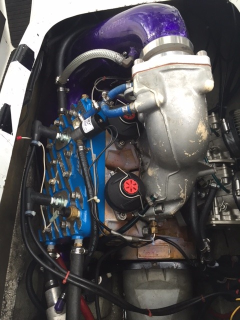

So it runs fantastic but It was time to dial it in. I've run a few tanks of fuel through it with this Coffman's pipe setup but I just knew to not hold it WOT for long. Yesterday evening I set out to see where it was really at and what the ski will really do now. With the T- tank down to 1/4 full I could get the revs and the speed up.
Unfortunately I could not keep the temps under control. My exhaust temps went over 1100 no matter how much I opened up the high speed jets. I had the timing at +1 so I tried -2 and -3 deg and it just ran a little worse but just as hot.
My next step is to swap the head. This one has only 41cc domes and common knowledge is that 43cc is the minimum for pump gas. Hopefully backing off in this area will allow my to use these race parts for rec. In my opinion a boat that can't run WOT safely till it's tank is empty is a broken boat. If backing off the compression does not do it I'll sell the pipe and carbs to the racers and try something else.

Well I had to start backing off so I swapped the 41cc dome head out for this Westcoast head with 44cc domes. It runs almost as well and about 50 degrees cooler but I still can't hold it under 1100 degrees when WOT despite timing adjustments and opening high speed needles. It was going past 60 on the GPS speedo and my revs were almost 7400.

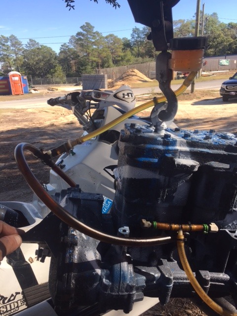

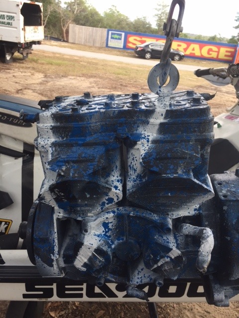

So lets see how I do. I'll take some more pics as I go along from here. It's been a bit of a rough start. I built a good used 787 up a couple weeks ago on cases an old racer gave me that he didn't remember the story on. I thought I was about ready for paint but when I torqued the head down it wouldn't roll all the way over anymore. Turns out the cases had been shaved for a stroker motor project or something so I had to rip it down and build it all over again.

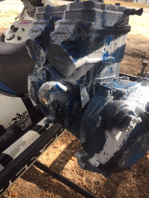

I've seen some engines painted in a "crinkle" paint that I liked the look of. Kingsspeedshop uses a truck bed-liner from Lowes. Well I had some "stone" paint that had been sitting around for years so I thought I'd give it a go. Turns out my stuff was much too coarse so it looks like corrosion. I've been splashing paint on it now for a couple days as I pass by just to try and get a little further away from that "Pinterest fail" look haha.

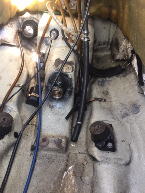

I got a little plumbing done. I'm going pre-mix so I'm using this motorcycle brake fluid reservoir for the tank that supplies the rotary valve chamber. It should not consume much but it's nice to be able to monitor the level at a glance and top off when necessary.

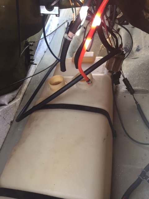

Setting a stock tank back in....
The paint work is starting to come out a little better. I left the texture coat out of the equation this time.
