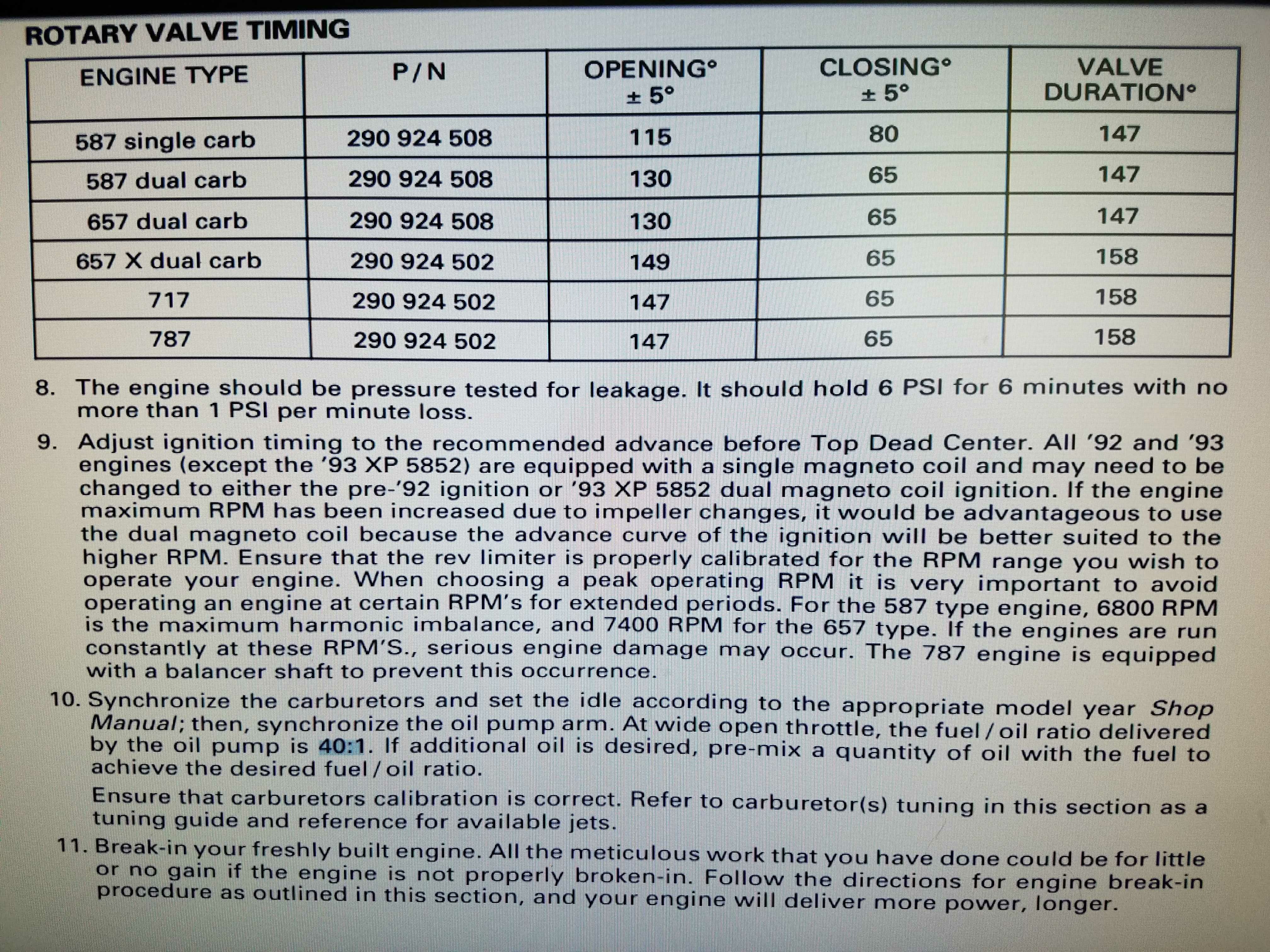

Could be Wes spark. Trim the plug wires back 1/4in at boots ends... Can always go premix, and do away with resiboir. Just cap off the line feeding the pump. Mix at 32/1..
Seadoo did, in the 96 racing manual. It's in step #10
If you'd like the manual you can download it free
http://bfy.tw/D79Q
Clearly stated on page 03-99.
The pumps putting out 40/1. Doesn't say anything about premix. Now, cutnpaste, I mean racerxxx, if getbbtechnical, if he were to premix, then what jetting should he achieve since the jets installed are flowing only fuel... You related to KustomKarl, lol
