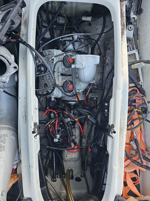

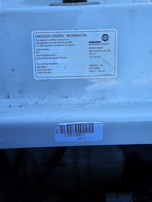

Send us a pic of the engine, someone will be able to identity it, also the serial number on the back of the ski , the last two digits are the year it was made. RFI means it has no carbs but is fuel injected.

I would take the spark plugs out and look in the cylinder to see if there is any water in there, almost sounds like he flooded the engine with water! If you can turn it over by hand until pistons come to the top on each side.

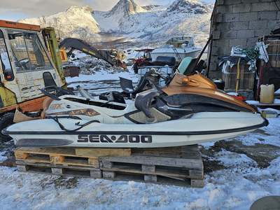

Where are you from? That’s quite a view in the background

It's in really rough shape but I hope to get it running and freshen it up.

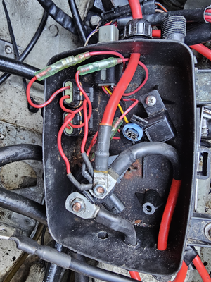

The loose red wire next to solenoid is one of the wires that go to main switch.
