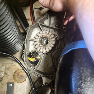

Yes seen the trigger coil. No metal shavings on the trigger coil but was a tiny bit of corrosion on the metal sensor. Cleaned it up and put it back in but have the same issues.
