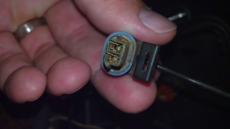

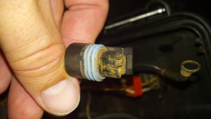

OK. Ski is sorted and running again. :-)

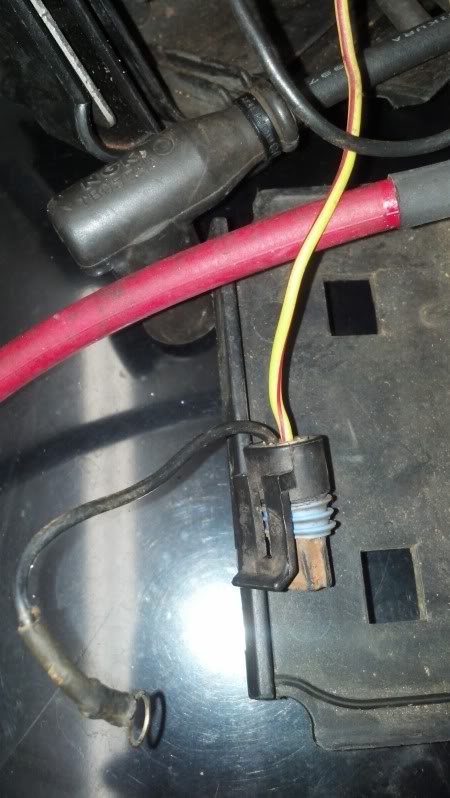

Sunk96 - I have a feeling this will be the solution for yours too. The wires inside the plug to the starter solenoid were corroded. I swapped the plug (just two wires - one ground, and the power that goes out to the plug on the top of the rear electrical box) with a spare that I had in my project ski, and first try everything works again.

Sure, I can snap one this evening and upload. It is pretty obvious when you pull the plug off the starter solenoid though. it just looked bad.
OK, here are pictures of the offending plug that created the problem.
