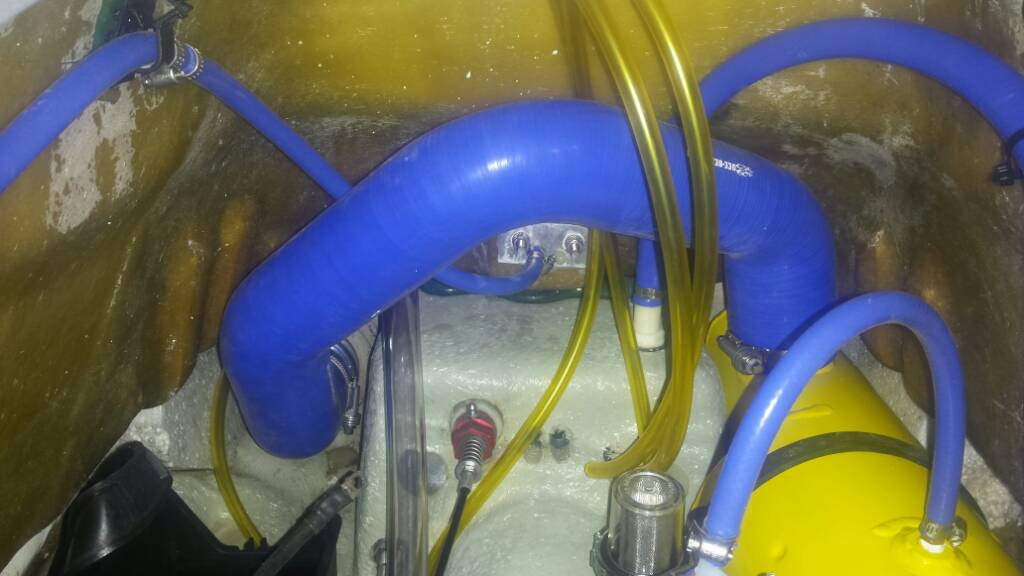

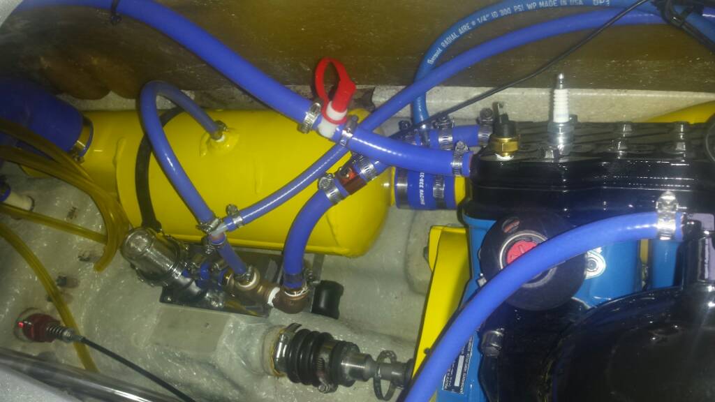

How long have you had it in the ski that way?I mounted the bilge pump basket using 3m 5200 adhesive,
( the basket being the plastic piece on the bottom that can unsnap from bilge pump to allow for cleaning of the metal debris filter screen )
Rob
What one did you go with? Can I get that at menards? Thanks by the wayAll last summer, the adhesive is no joke, there is one version that sets up in 1 hour, and 1 version that sets up in 7 days.
Thanks guys, what is the best way to mount the bilge pump in the bottom of the hall my last one I just siliconed it to the bottom....

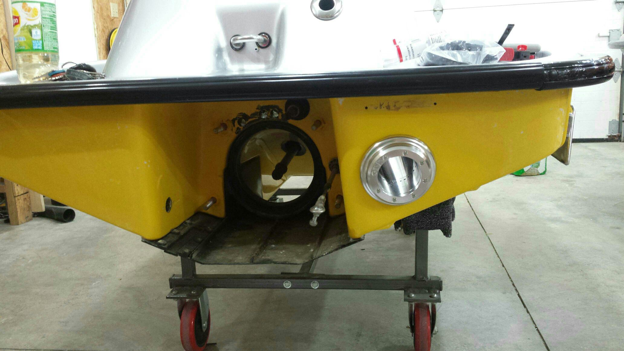

did you drill & tap that spot on your ski or did your model already have that port?
You don't tap it but you do have to drill the hole....did you drill & tap that spot on your ski or did your model already have that port?
What made you take the hin off?
Quick! Call the DNR stolen ski! Lol
Lol , yea it is, best idea I had, I should have it all done this weekendNice. I like that you are ahead of me by a few weeks so you get to ask all the questions I'll have lol.
Is that a bilge switch in the middle?

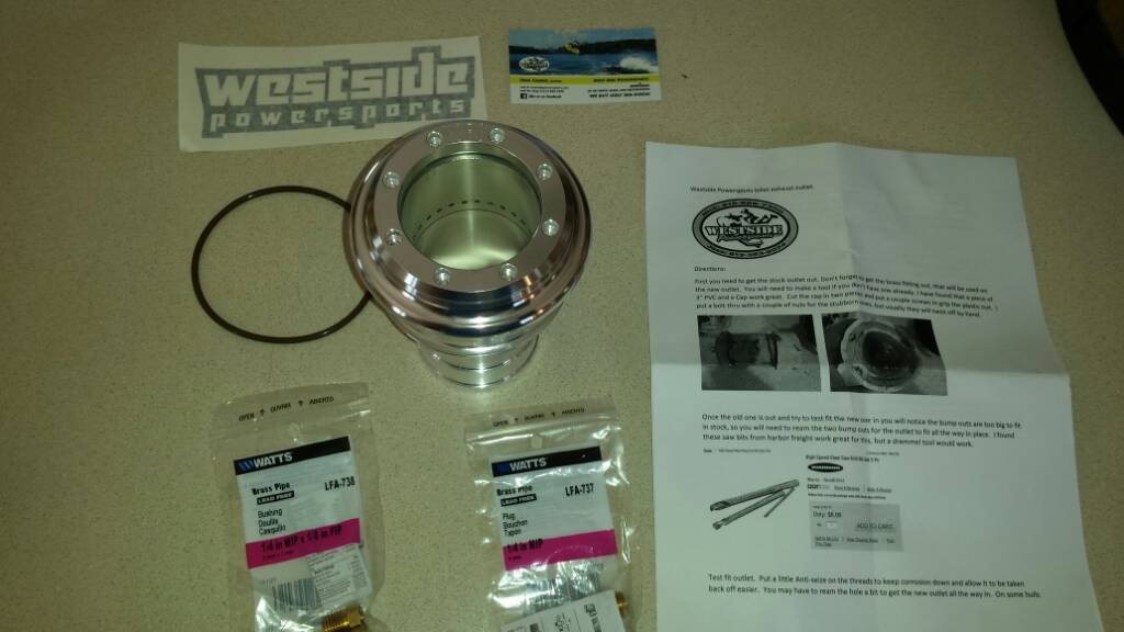

Thanks man , yea you can get that kit from nick , I think it's $175Awesome thanks guys, going to check out that pump stuff.
Also that is looking amazing man. Loving the build!
Did you buy that hose kit from a vendor here?
