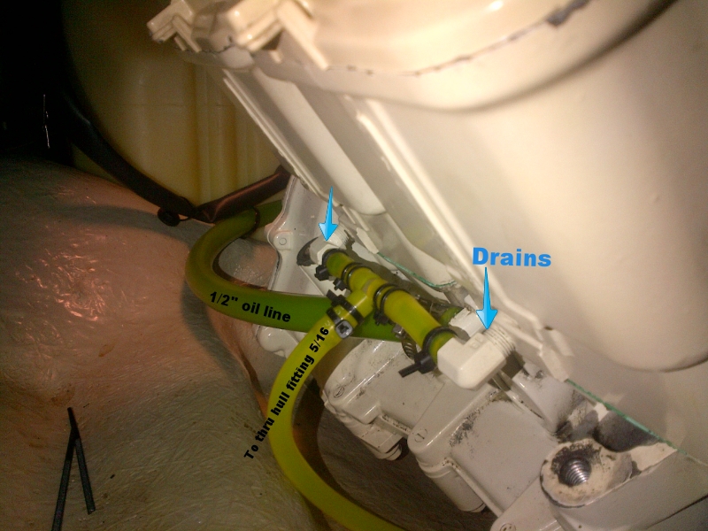

still haven't worked on ski...waiting on rain to pass. Can anyone let me know fuel line size and about how much i will need. also water lines?
1/4" fuel line, 20ft. spool from you local autoparts store. Home Depot has full stainless steel hose clamps, $7 for a bag of 10, gonna need 3 bags to get it done IIRC.
I think the water line for the scupper bilges is 8mm or 5/16" I'd say roughly15'
Kicker has the water line info somewhere.
