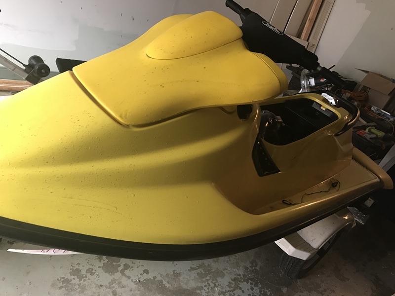

Well I finally took the plunge and pulled the trigger on a local 96 XP w/double trailer. This will also be holding my 97 gtx. With all your help last year I restored my 97 gtx and this year it will be the 96 xp but this time around I want to do more mods and really wake up this 787! Being a noob to mods I am hoping to bounce questions and get some opinions on part choices and such.
My goal is to have a solid ski that will run pump gas, wont require constant tinkering and be a nice wave jumper. This will be mostly lake driven with some river time on her as well. Not super concerned about a high top speed but want to make her quick out of the hole.
Here she is, the top was buffed before purchase but I will be stripping the rest of the graphics and finishing up the hull. This will be a SLOW build because I am still moving parts/tools/house projects at the new place. You know how that goes lol!
Anywho here are some pics and some pics and some of parts on order.

I think for the color scheme of the ski will be yellow with carbon fiber accents. I am thinking the hood, grab handle and some decals will be a CF/black theme. Then the trim accents a nice anodized style "duplicolor metalcast" gold. The engine I will probably just do black/blue to match the head. Considered a nice purple/black but hate to paint a fresh WC head like that lol.
