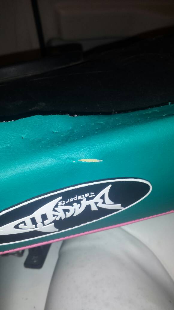

Devastation.
I have no idea. I was messing with the carbs, grabbed the seat and saw it. I'm guessing it snagged on something when I took it off.
Are you sure that the cut wasn't already there before you stretched the vinyl. That would be my story
If it didn't have the bazillion staple holes in it, it might be my story too.... but doubt they'd fall for it now
Wish this site wasn't family friendly, I really feel like saying some dirty words
Call them and say you noticed after you stretched it the seat hasn't been sat on or ridden. Worth a try.
I would try for a new one see if they'll bite. being where the rip is you might be able to cut a small piece of the teal and glue it on the back side at least get it water tight.

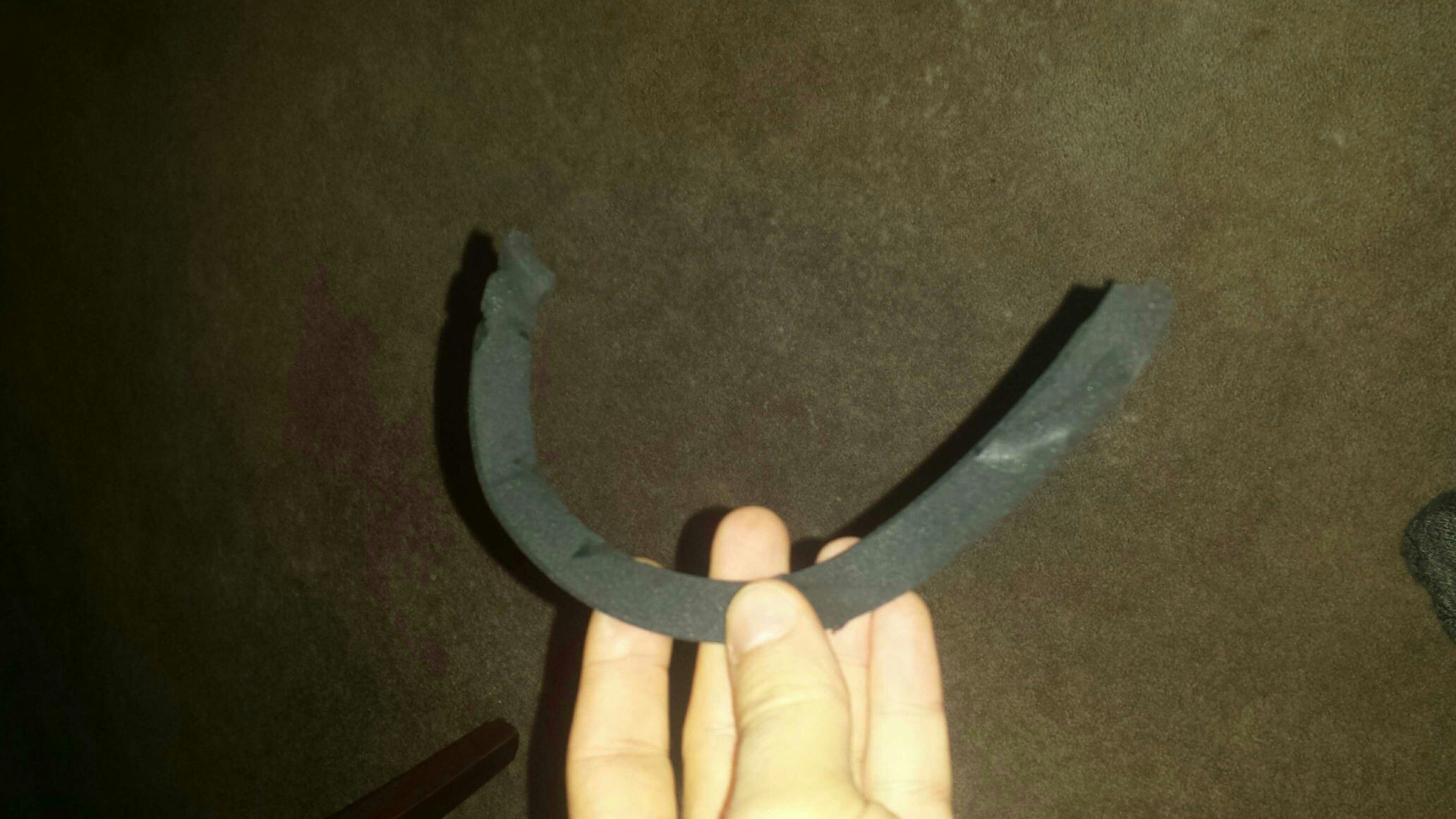

Weather was overcast but well enough to take her out today. Glad I did....I putted around the boat ramp and it would rev like it should, start building speed, then it almost felt like the drive shaft was disengaging. Would still be revving high, but wasn't picking up speed. Turned over fine and the compression is there. Any tips?
Btw, the weather was 70, but the water..... it wasn't....
There weren't any water leaks around the carrier bearing I assume. You rebuilt the pump right?
Yup, no leaks and replaced all the rings and jet pump oil. Only thing I can think is maybe the drive shaft didn't seat all the way? But I figured it would've made a grounding sound and it didn't
This probably has something to do with it..... part of my neoprene seal was in my prop
How in the hell...
