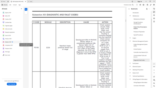

Try the recommendations in this screenshot , could be a bad sensor as the P1006 says out of range.
