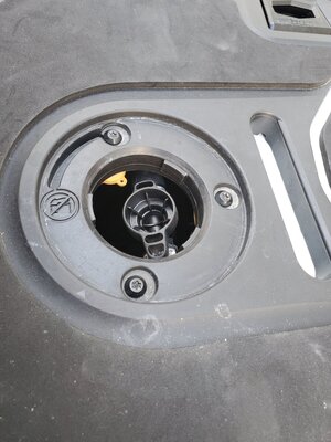

I installed a ball valve, easy access.
20231024_162843.jpg.
