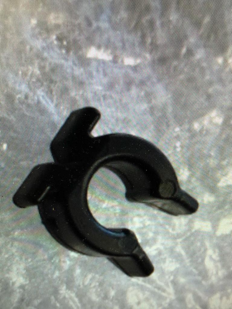

The top glovebox lid keeps detaching on brand new GTR 230. Anyone else having the same issue?
It’s a pain to keep snapping the cover back in place while riding. This is the top cover between the rider and the steering and not the inside watertight phone compartment.
There is a missing plastic lock missing at PDI that fixes this issue
Any chance you have the part number for this? I'm having the same problem, cant seem to find it on the parts diagram though, only in the service manual.

Give me a few let me see if I can Find it for you
Thank you! I found another parts diagram that seemed to be slightly updated, with the only difference being 26400015. I'm not 100% sure if thats it or not. If it is, it doesn't look to be available for purchase anywhere lol
Yes that’s it’s 264000150
I don't have so much an issue as it coming off, my issue is it doesn't click every time and you have to kind of wiggle it a little. It seems like the left hand side of the glove box is loose. Does the group think this same part# will fix that issue as well?
It should
Your glove box cover may not click because it slides to the right without the clip. I used a small zip tie in the place shown in the diagram posted above (thanks jakgal04!!!!) and it solved my issue.
