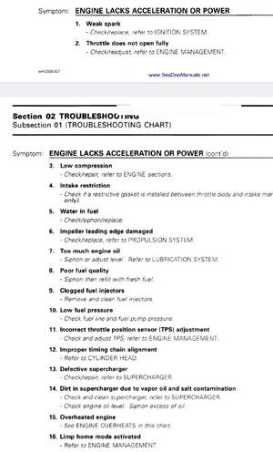

Good day everyone. Just purchased 06 rxt supercharged. First ride and not even close to 65mph. Gauge was closer to 50. Question- previous owner has what looks like wrong battery in it. Would this affect that much performance, also not sure what cluster gauges should look like. Rpm, gas and speed working, NOT numerical speed, depth had 2 dashes and battery signal was what appeared on, unless it is always visible. I know it could tons of other stuff, but concerned on this end first. Thanks.
