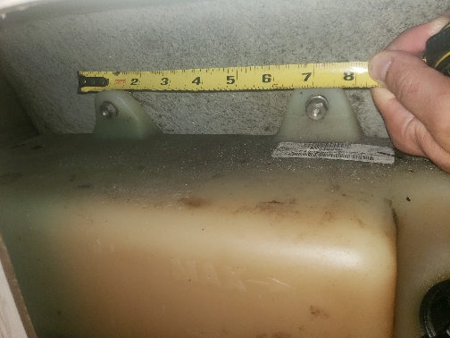

Oil Tank cracked any repair tips or do I have to buy a new tank?
Any place to buy a new tank or good used?

Unfortunately, the way it's cracked is around the support areas of the screws.

It's cracked from the top where you bolt it to about 6-7" down the backside. There would be no way to repair around the top where it screwed in. I'd believe in time the constant force on the water will crack it more and more...

Does it look like this ?
I just had the same type of problem with my Speedster tank. I bought a cheap plastic weld kit at Harbor Freight and used it to "weld" the cracks with the black plastic "welding rods" that come with the kit. It is fairly easy to remove the tank. Use a cheap Harbor Freight automotive siphon pump to remove the oil from the tank first. Clean the tank with brake or other aerosol cleaner. Rinse the tank out with water. Allow the tank to dry, or use a rag or air hose to dry the tank out inside. The tank cracks at the plastic bolt holes, if you tighten the nuts too tight, so when you re-install the tank, use caution to tighten just enough to be snug. The nuts are nylon "lock" nuts, so you don't have to tighten much.
