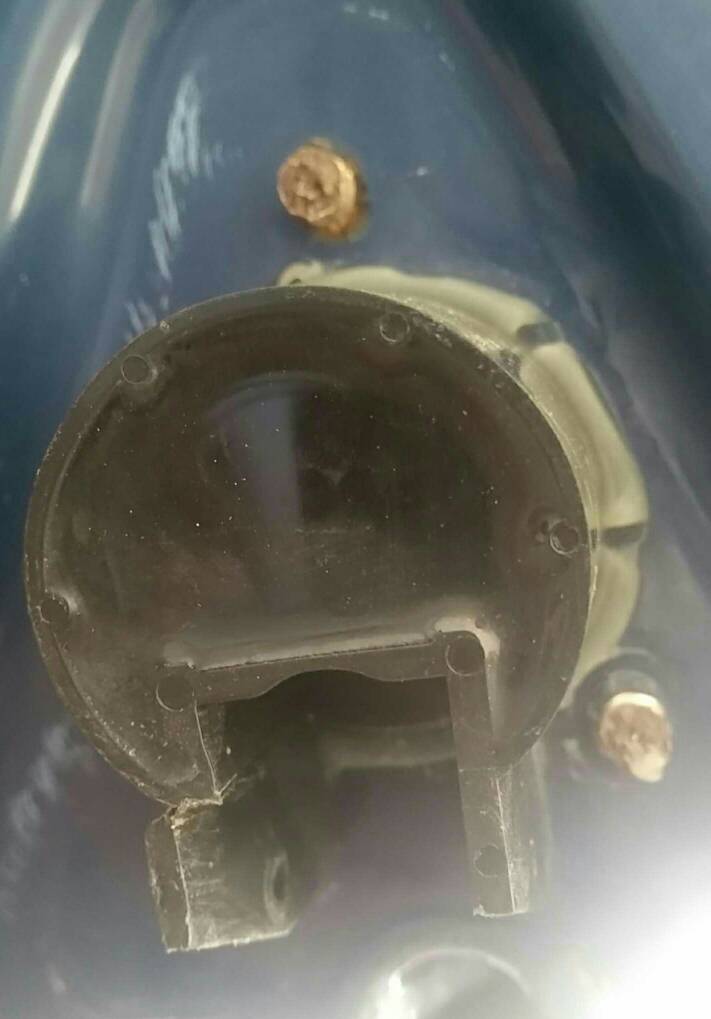

When flushing you are actually flushing intercooler and exhaust.
The cavitation can be caused by wear ring or carbon seal.

Do I need to remove the SC if I need to replace the carbon seal/seal carrier?
No. they have nothing to do with each other. SC is bolted high on the backside of the engine and the CS is on the driveshaft of the back of the engine.

#23
True... I was able to reach below the super charge.
I was able to score an OEM season GTX cover locally at the dealer when I went to pick up spark plugs, engine oil, coolant and the seal carrier.
The carbon seal is not available so I might end up ordering it instead. The only had the metal piece. Though I thought they come as a kit but that wasn't the deal

You will have to bolt the pump back onto the hull to change the carbon ring. Slide the metal collar towards the back of the hull and remove the c-clip. Then remove pump and driveshaft. When removing driveshaft be careful not to pull out carrier bearing from the back of the motor.
Change the rubber bellows that holds the carbon ring also. This is what puts tension on the metal top hat collar. They sell a tool to help pry that metal collar back but I've done it before without it.

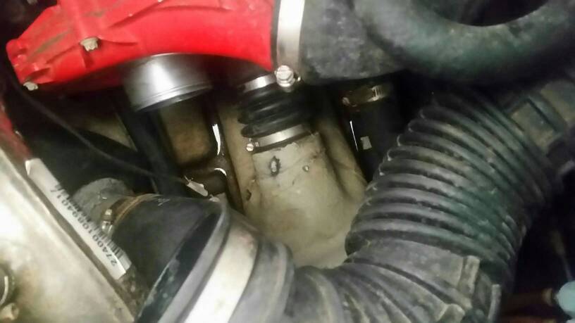

It might be easier to pull supercharger and get more room. (Only 3 bolts)

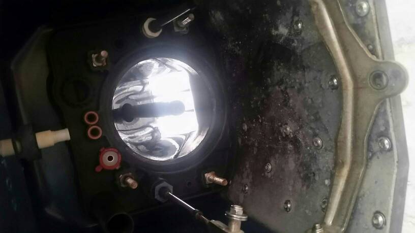

Oh and those small allen screws in the rideplate look like they might be letting some coolant leak out. Look into that before you put the pump back on.
