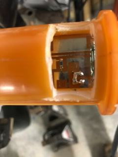

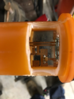

1.) The fuel gauge doesn't work (empty all of the time). I have taken the baffle out and confirmed the float looks good. Jumping the gauge wires will spike the gauge to full so I assume it is my "F1 Fuse" in the baffle. I've seen lots of ways to open these up at solder them or purchase new for $235. My question is - is there any safety risks associated with soldering the terminals and removing the fuse on a fuel baffle? I'm all for saving money but $235 vs the safety of my family... :confused: Has anyone done this and had issues? Is there a way to put an inline fuse in to keep the protection of the original fuse intact?

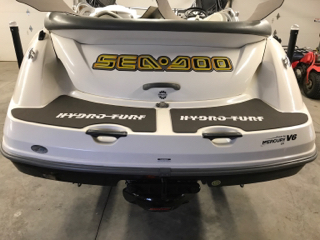

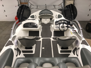

I got it buffed and waxed and installed hydro turf purchase from pwc muscle.com:
Smith trailer guide posts and light (painted black - can post pictures if requested)
Lowrance Hook4 with gps and downscan (I'll do a separate post on this install)
Installed 1/2npt brass drain plugs with blue led plug lights with this I also installed some Pyle speakers with LEDs and an additional blue LED up under front seat to basically light up the entire boat:
I also did the F1 fuse DIY fix of removing the fuse, bridging the circuit board with solder and installing an inline fuse as a replacement to get my fuel gauge working.
