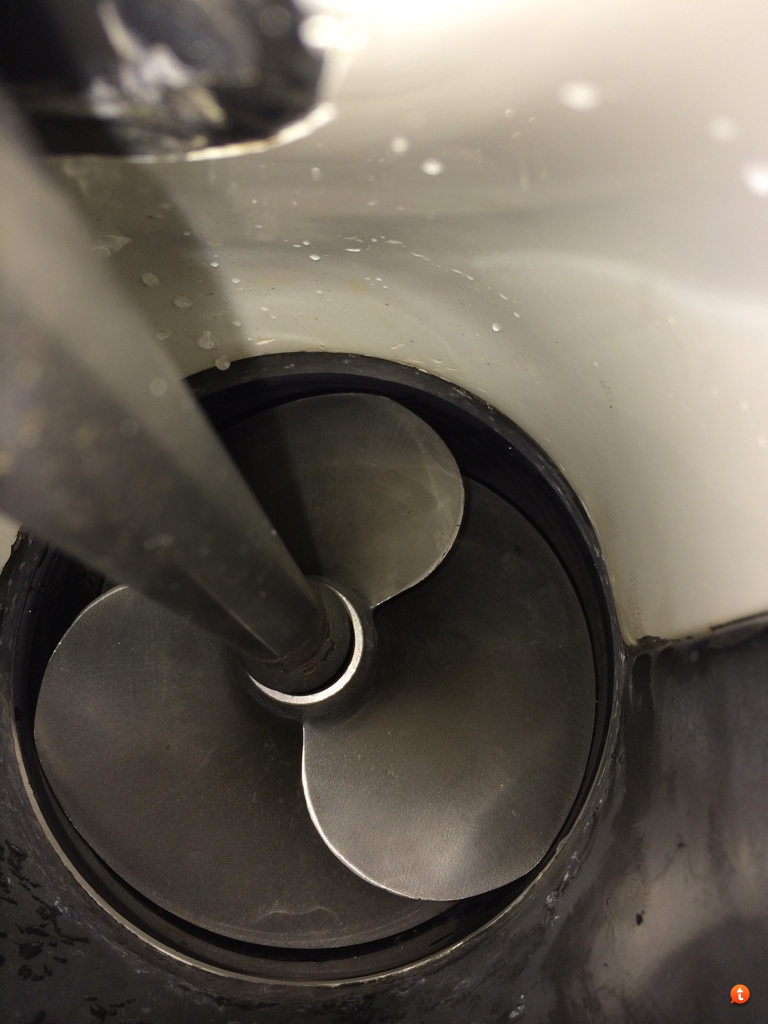

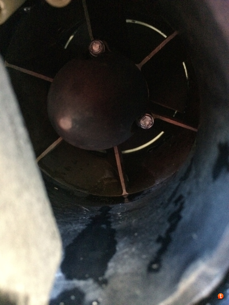

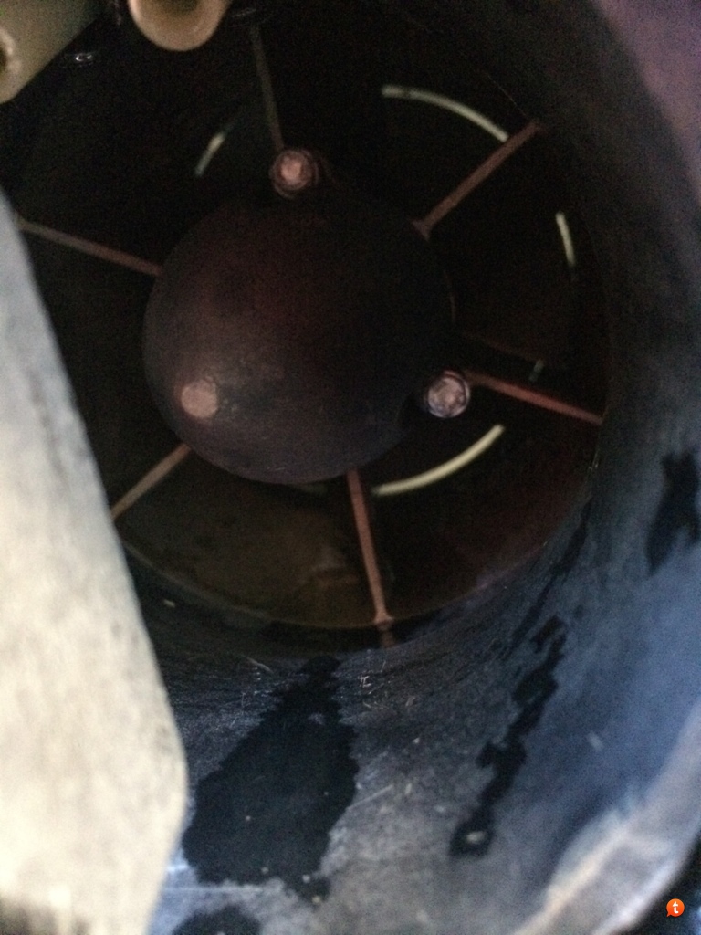

To not get any power to thrust forward or your ski doesn't move at all in the water, your jet pump isn't working. Your jet pump works off of a impeller prop inside of it and it is spun my the crank shaft from the engine. Check the jet pump to see if it has anything blocking off the intake grate on the bottom of the ski.
Take off your PTO cuppler cover off and rotate it by hand. Please notice if your engine is turning over by doing this. Then have someone look into the jet pump and see if the impeller is rotating when you rotate the PTO cuppler.
If the engine doesn't turn over, then your drive shaft isn't connected to the engine any more and if your impeller isn't turning then you have a drive shaft/impeller issues.
If they both work then you need to replace the wear ring as you are experiencing cavitation in the pump.
This issue can be fixed, but you must narrow down where and what is causing it.
